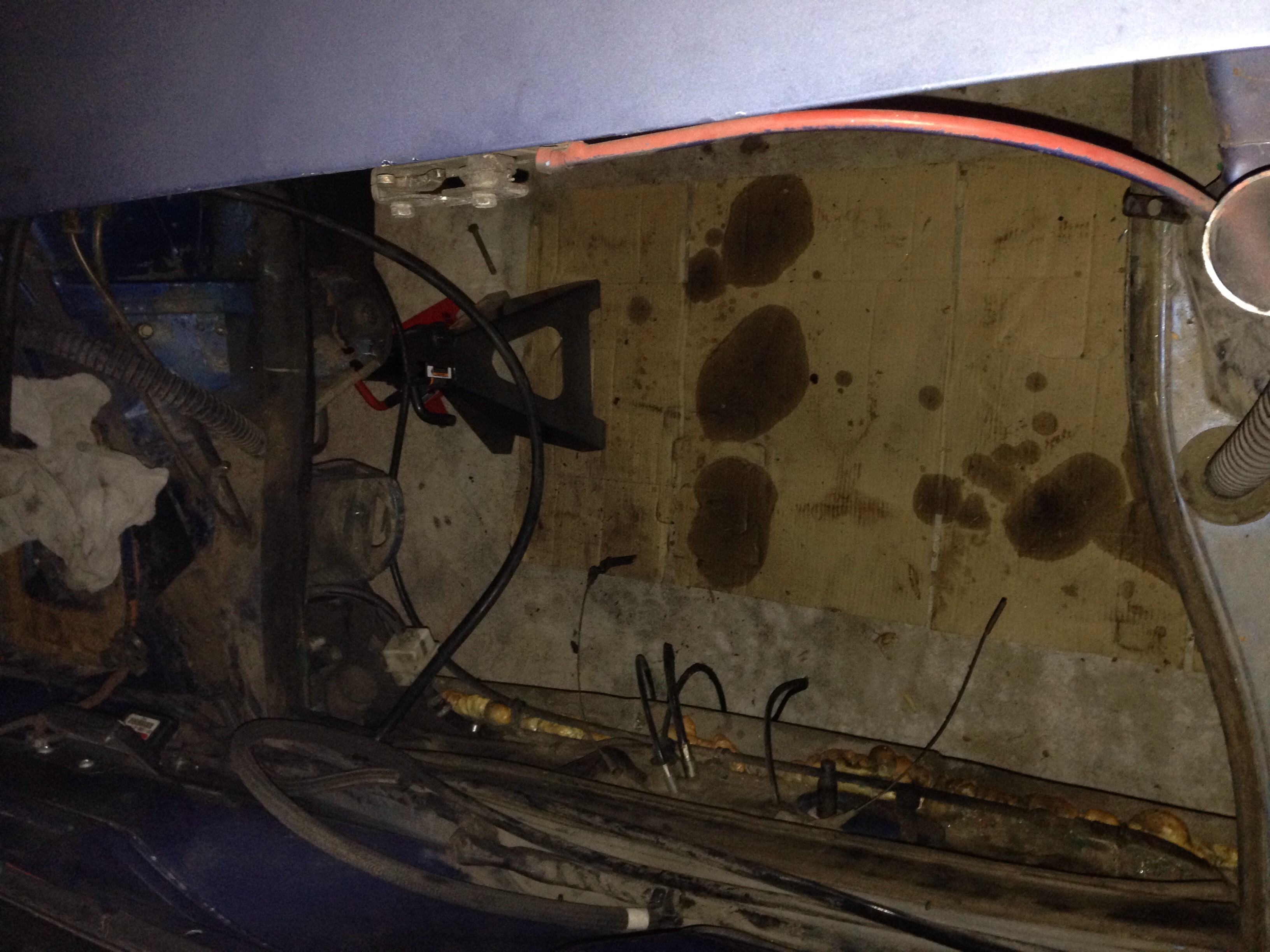

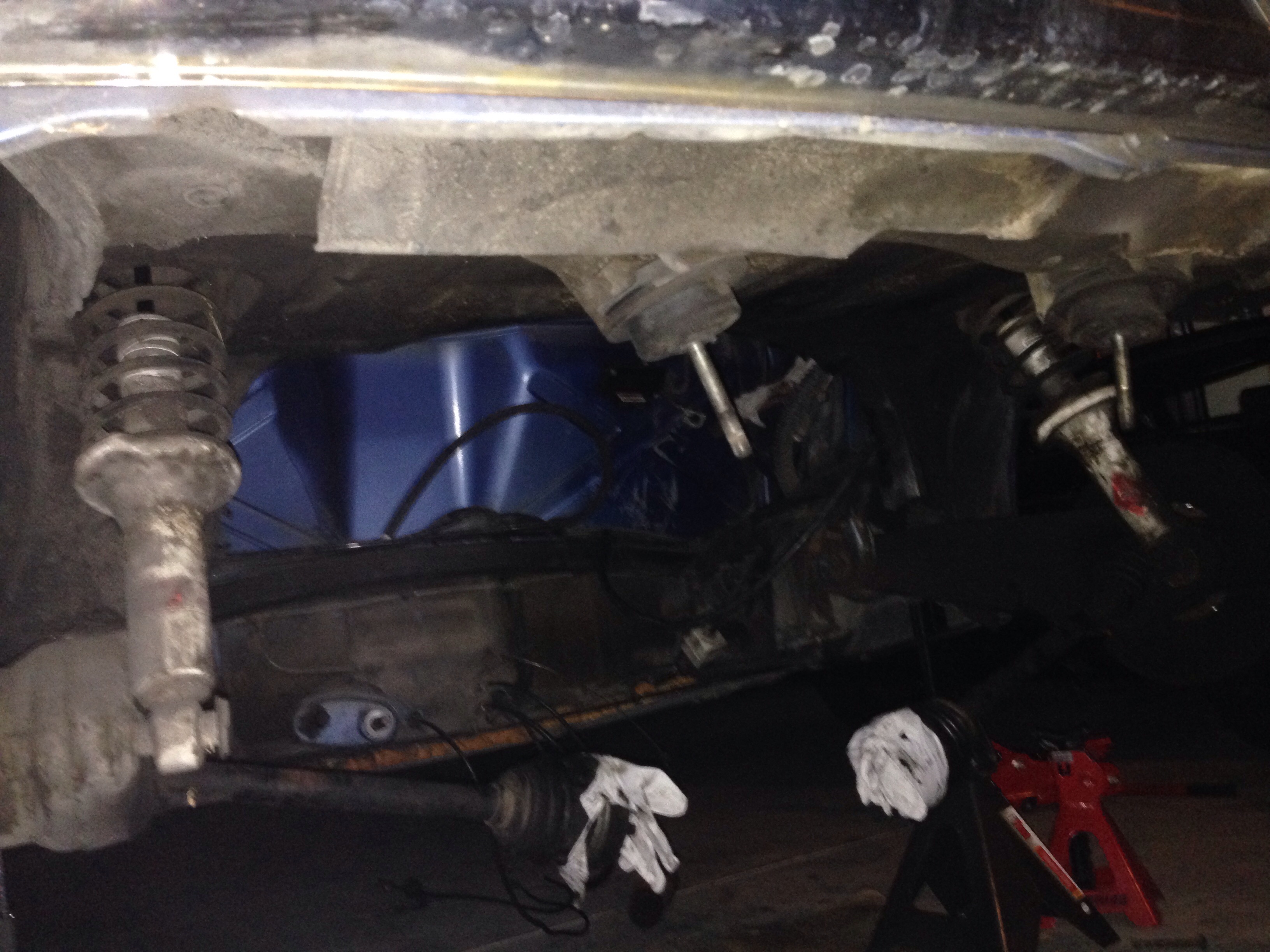

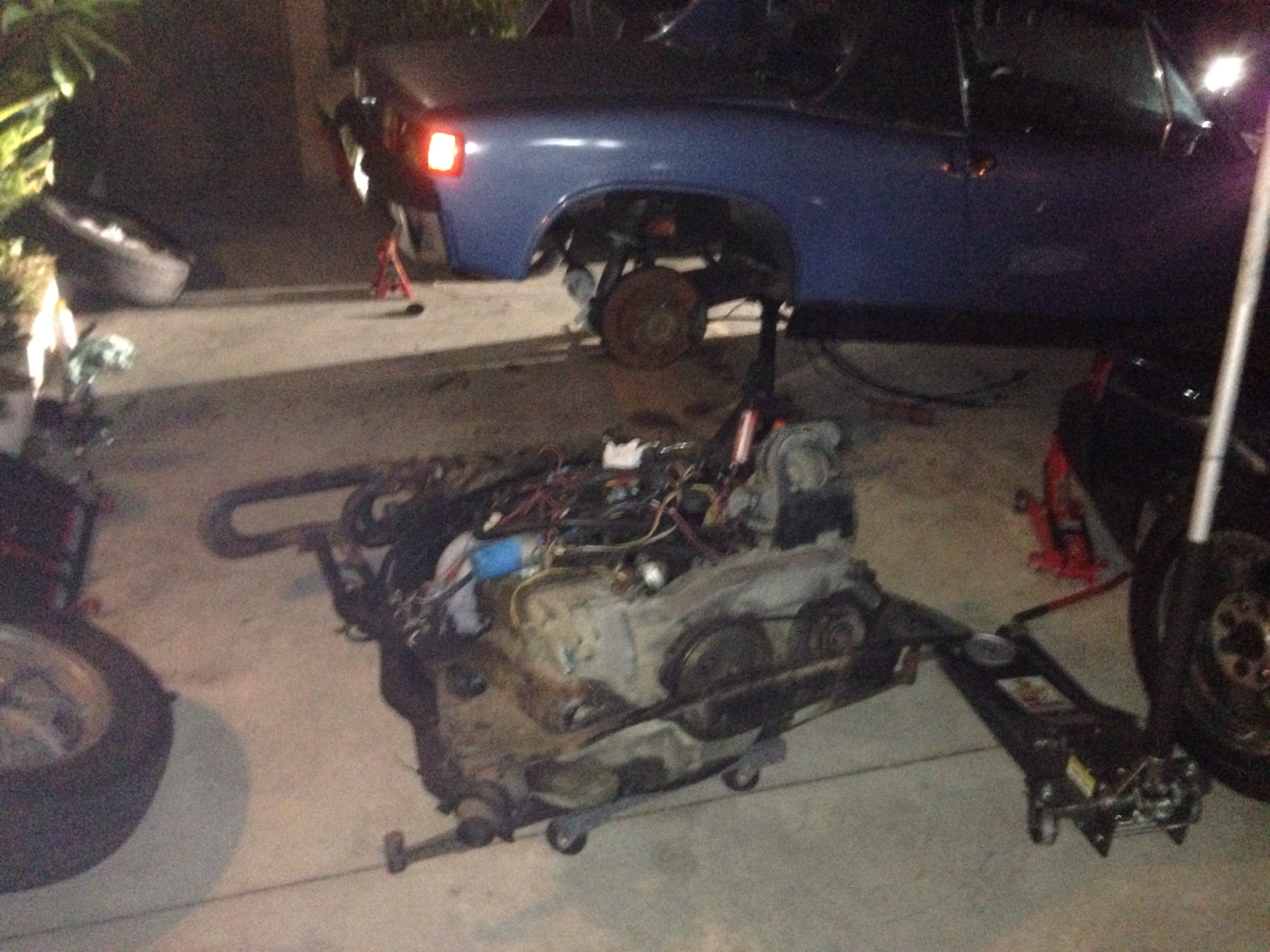

Thank God I was able to pull out an engine of my newly acquired 71 1.7 megasquirt and I was able to do it for less than 4 hrs. From clearing all electrical lines, fuel lines, cables, linkage and other parts before dropping the engine to a dolly.
I hope I can install it back after fixing the rear suspension console with the help of a good fellow 914world member who is going to do the welding job.

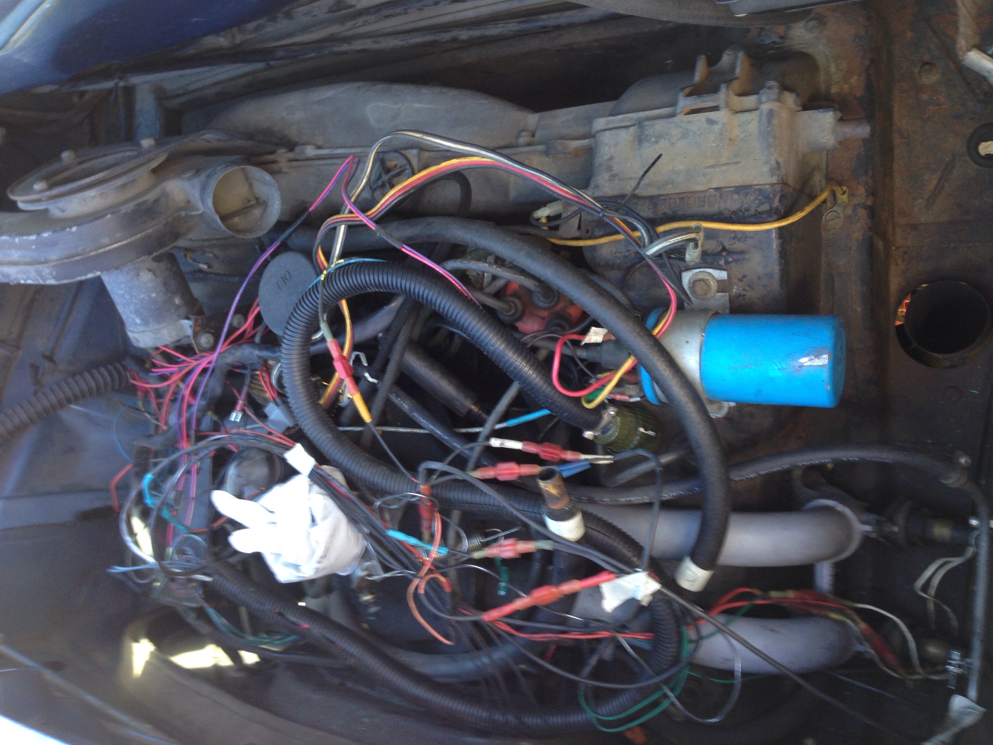

Thanks and I hope I did the proper labeling of the wirings specially it is a megasquirt and the previous owner is the one who installed it. I'm very much familiar with my Ljet on my 75 but not on this and not even original djet.

Yes my wirings are really a mess but I got like that from the previous owner who installed it but it is a good running engine with 1 try to starting the engine and the idle goes to the righr idle around 800 to 900 immediately upon start. Well I started re taping them together those wirings. I hope it will look cleaner when I install the engine. And hoping the engine will start.
