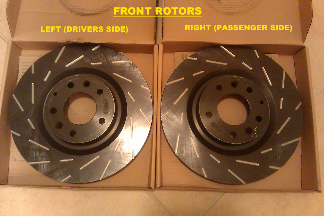

For solid rotors, a groove to release gasses would be better than drilling. Drilling a rotor will make it weaker and prone to cracking if the drilled edge is not eased or rounded off.
BTW, if you try to drill rotors in the car, they will look like shit. It needs to be done in a drill press with a template.
