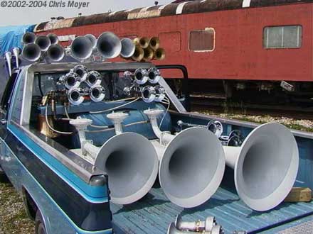

I like the AC compressor idea. The magnetic clutch would toggle on and off with a pressure switch. Plus adding a train horn along with the air ride would be cool
r_towle
Nov 19 2014, 09:46 AM
ummm, those horns give me a new idea....wow, wonder what those are from?
rhodyguy
Nov 19 2014, 09:55 AM
a locomotive? there is a rail car in the background.

orangecrate
Nov 19 2014, 03:19 PM
Yah I like those horns. Warp speed Mr Sulu!!

messix
Nov 19 2014, 06:19 PM
QUOTE(r_towle @ Nov 19 2014, 07:46 AM)
ships horns
