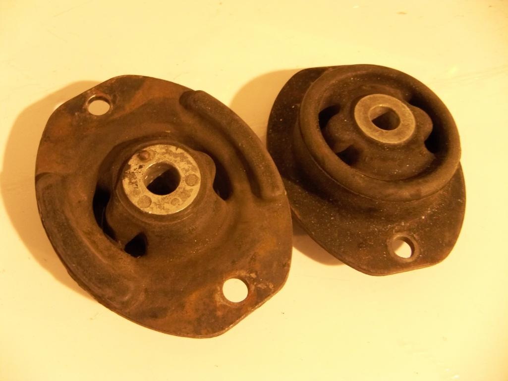

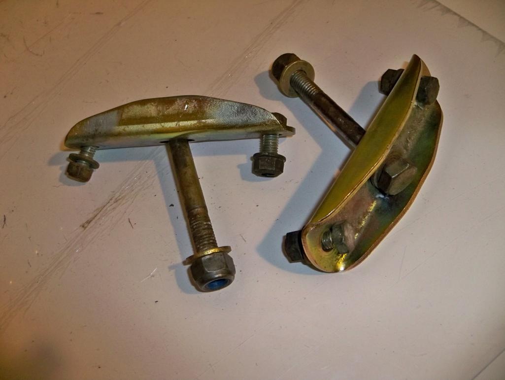

OU8AVW
This is what I have.
This is what I need?

bdstone914
Mike
You have what you need to mount the bar to the body. There are no mounts used at the end of the bar. If you need the rubber mounts that attach to the engine mounts and bar buy them new. Used ones get wedge shaped.
