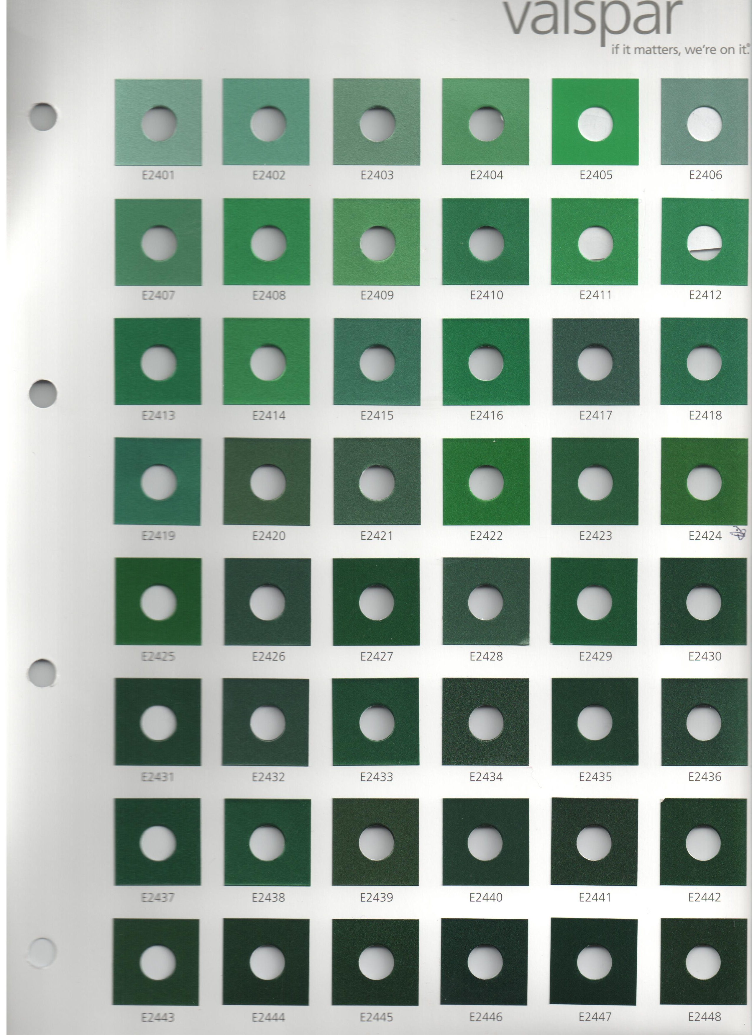

Now i have to pick the paint color. I thought it would be easier to just match the stock color. Anyone know how to find the formula for Palma Green Metallic?
On the attached chart i think i found one that looks pretty close.

E2409 looks pretty close to me, but that's based on a picture over the internet. wink.gif
swood
Really? I put the sheet over the paint and E2424 looked closest. but of course its a 1/4" hole... not going to be a weenie over it driving.gif

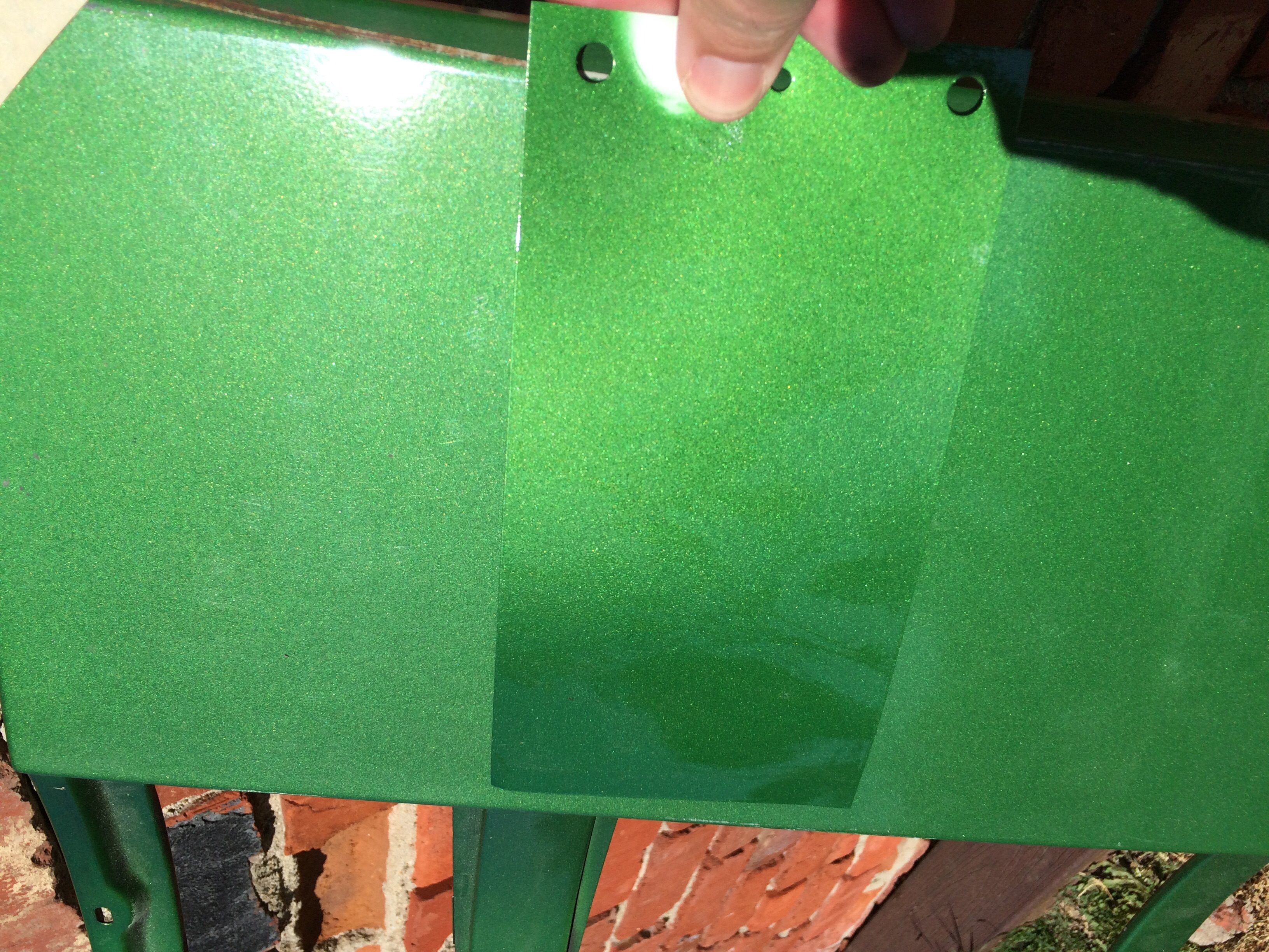

I was able to get PPG paint from the formula they had on file, and it matches what I have under the front hood.
swood
PPG color match draw down. Looks pretty good to me

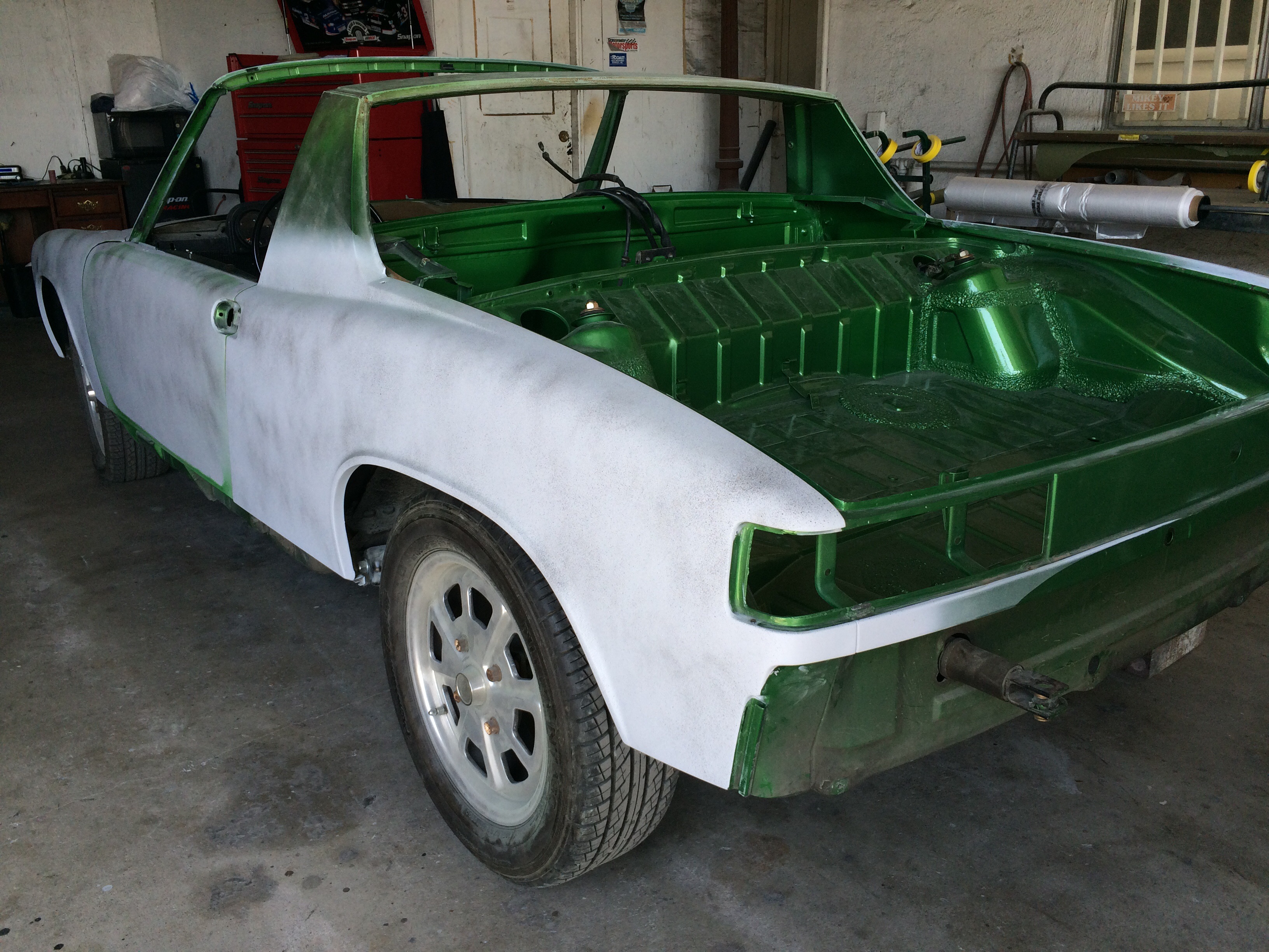

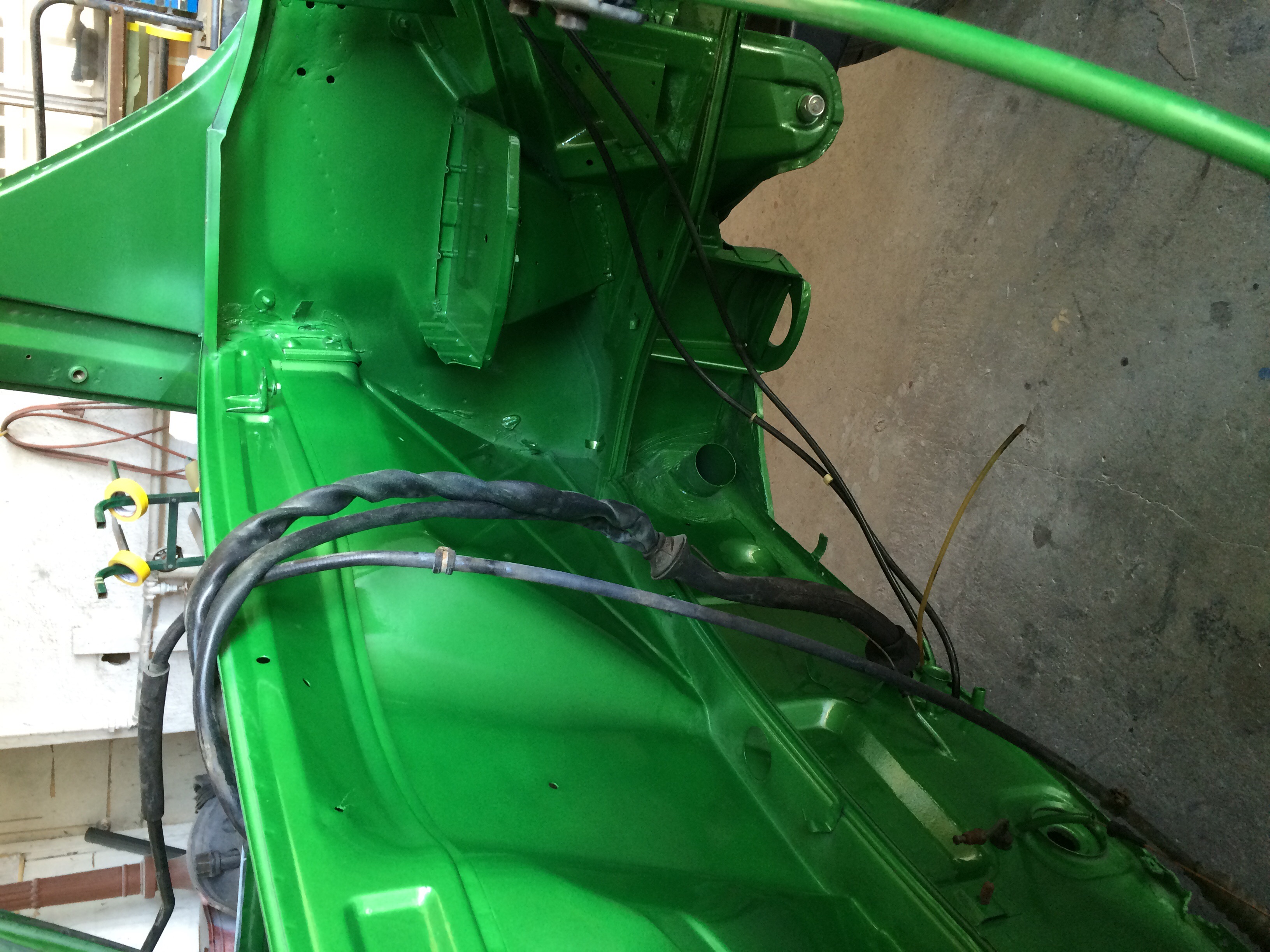

Progress

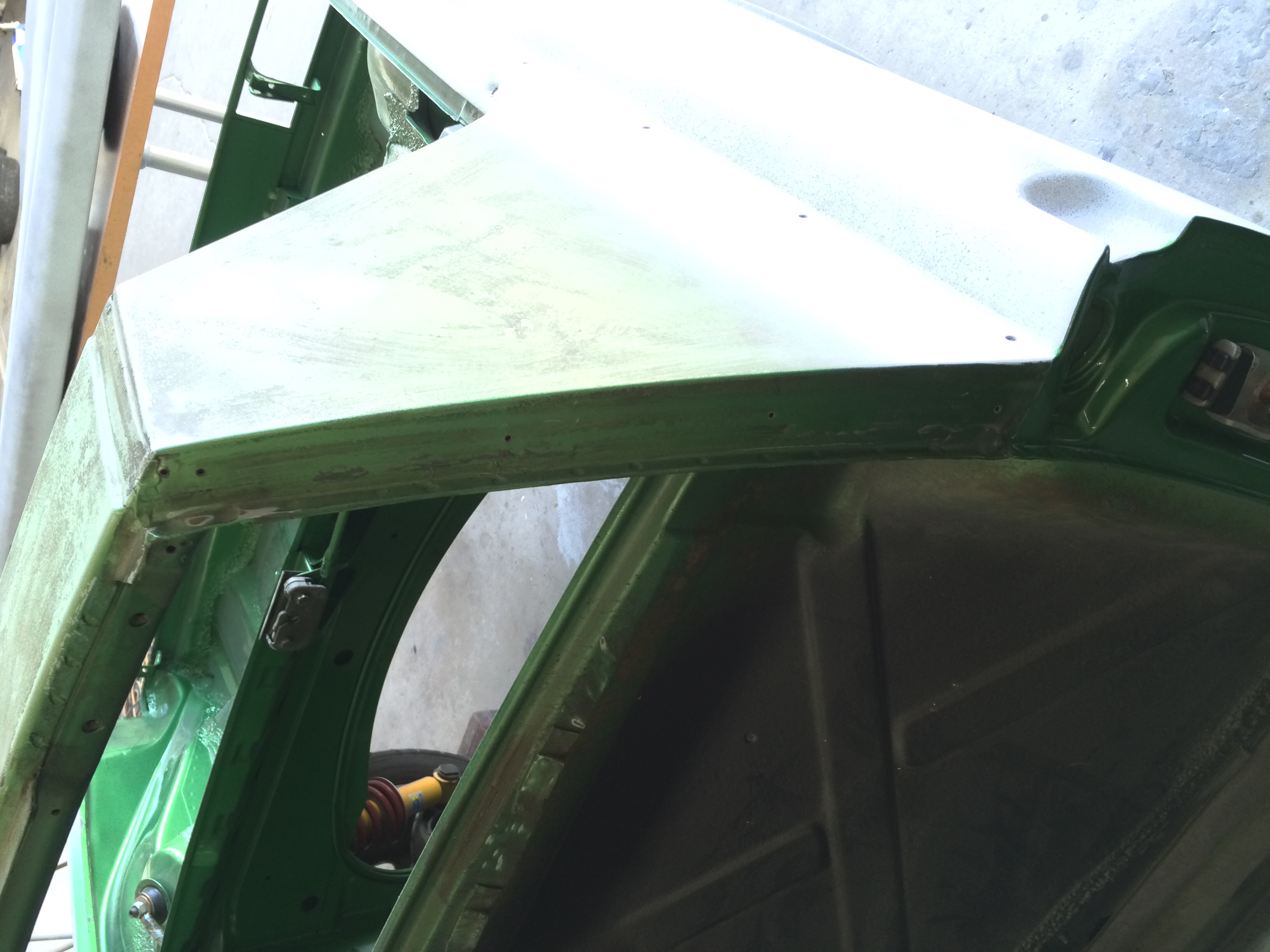

Anyone have a few pics of this area either finished or almost finished? Referring to the front side of the sail panel. The painter was wondering how all the vinyl and trim goes back on. Don't have my photos handy
euro911

QUOTE(swood @ Apr 11 2015, 07:01 PM) *
It needs to be painted body color all the way around, it shows in spots around the trim.
