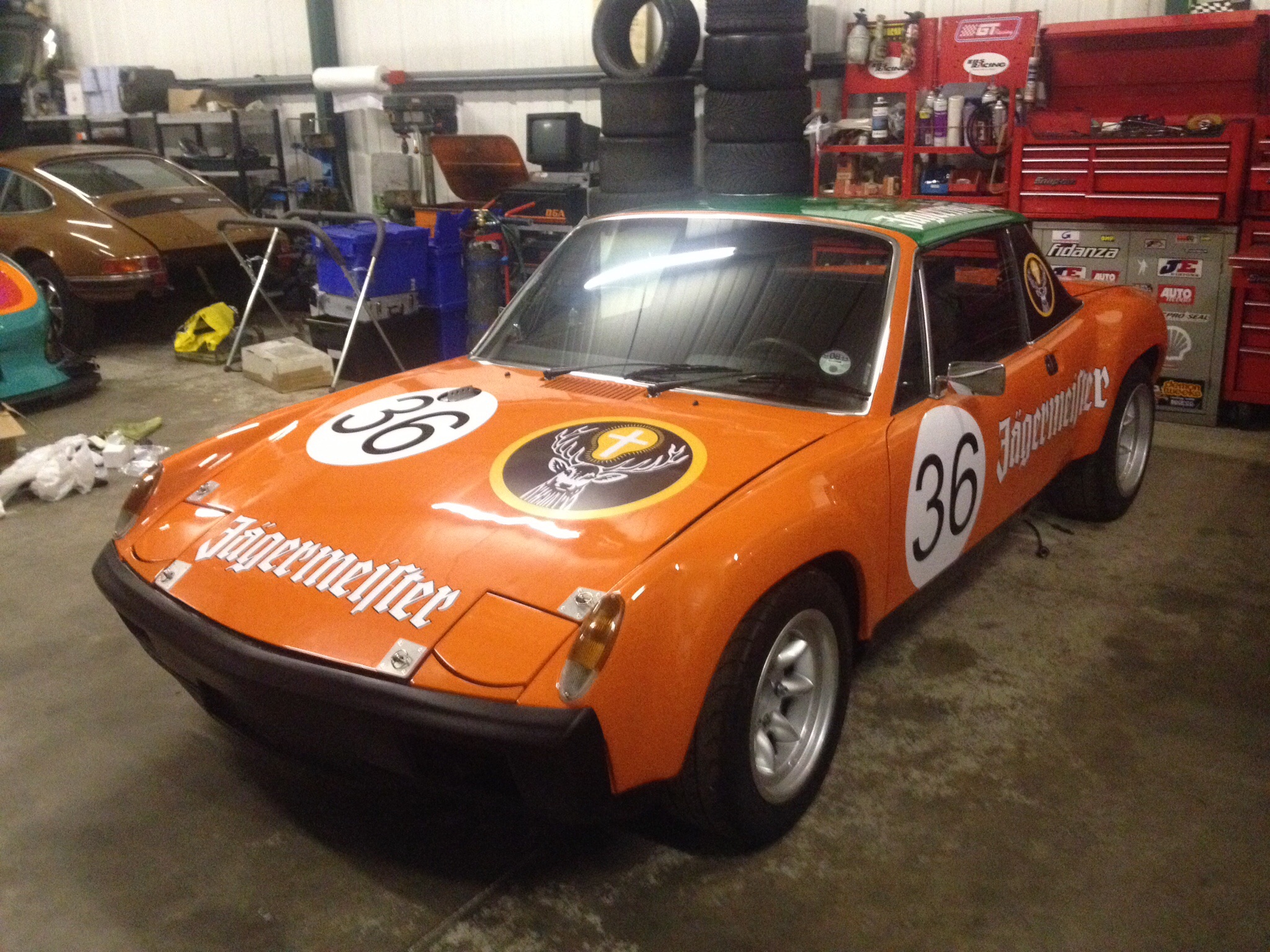

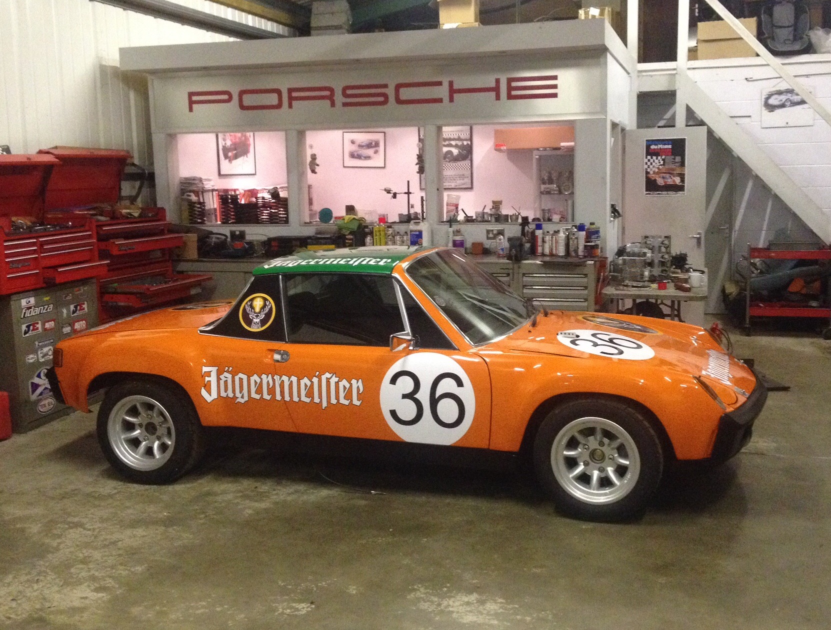

EdwardBlume
From an LPR event.
SixerJ
So my mates going to be in trouble with this then KMA.gif ........ Imperfect replica based on a -4 chassis that had been previously and quite nastily converted to a -6 by the PO. Quite a lot of work had to be done to undo the nastiness. Engine is currently being built up as a 2.5 and will be weekend bit of fun
QUOTE(SixerJ @ Dec 4 2014, 12:46 PM) *
Building on a /4 chassis is perfectly fine. Nobody has said anything about that being a problem.
The problem i'm having with some of these replica cars is that people use late model chassis with clear and easy to spot differences.
Makes no damn sense to me when i can walk up to a car and after 5 seconds tell the owner that it was built on a '74 chassis.
And while i'm picking nits here, the green on the car you pictured appears too bright. The actual color used was "Conda Green" which is a bit darker.
And the windshield hoop should also be green.

SixerJ
QUOTE(SirAndy @ Dec 4 2014, 09:41 PM) *
That's what I mean about imperfect, on the whole a lot of effort has gone into it considering the cars starting point and it's a bit of a shame that the hoop is not Green and the number font isn't quite right.....we are being very picky and I wouldn't say no to it
