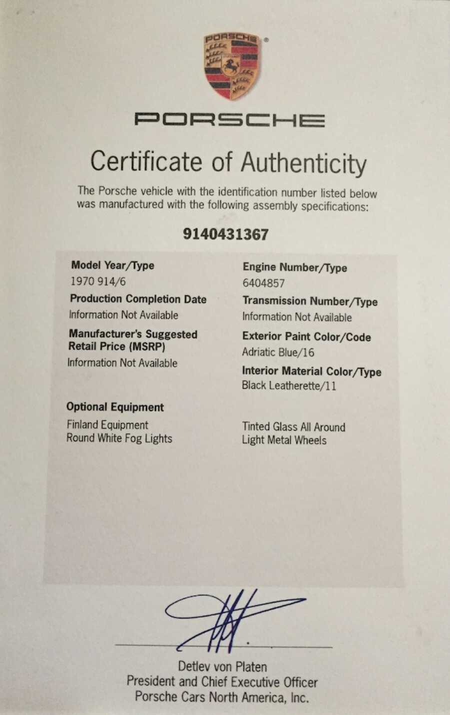

I would think if it was a factory M471 optioned car the COA would have listed it? idea.gif
Nice color ! Hope he gets his asking price...
Vin is not in the data base that I see?
https://www.flickr.com/photos/126218907@N06...57649298414942/
http://forums.pelicanparts.com/porsche-car...0-914-6-gt.html
Larmo63
"Believed to be" is not believable. I think it would have been stated it on the COA too.
Gustl
this car is definitly not a factory built M471 car
this one has #1376 which means it was built somewhen about 04/1970
the factory built M471 cars started in 02/1971 +/-

pete000
Some one should post the VIN to the data base !
9140431367
gms
well it isn't on the list and the COA doesn't list it...so no

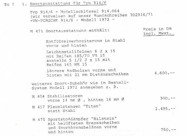

QUOTE(SirAndy @ May 27 2014, 11:16 AM) *
It seems there is a LOT of confusion about what was part of the m471 package.
This thread has some good info:
http://www.914world.com/bbs2/index.php?showtopic=108357
The m471 package ONLY included:
- Metal Fender Flares
- 6x15 Alloy Wheels
- Longer Wheel Studs and 21mm Spacers front/rear
Anything else was extra!
IPB Image

i stand corrected
- i had never seen Jeff's 1971 m471 dealer option document(s) before - one of these applies to 1972 model year cars
- the other March 1971 scan portion applies to “Competition Option Group 471” for models 914014 and-019 - whatever they are
