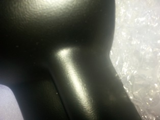

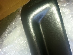

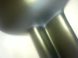

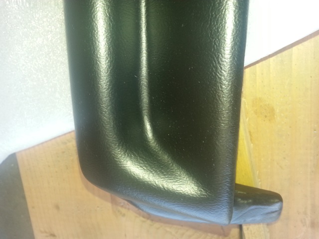

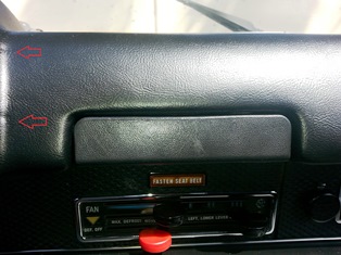

I think I paid just under $1100 for lower and upper dash. They also fixed the common sag over the instruments. About 6~8 weeks lead time cause of back orders. I think it's a 2 week process.
Here are some pictures of the more critical areas. The grain is not exact, so I'm glad I did both upper and lower dashes. As mentioned above, the dash seems to have a "puffier" look than stock.
Click to view attachmentClick to view attachment

QUOTE(Highland @ Dec 8 2014, 03:48 PM) *
To my eye the more pronounced grain is what is most noticeable. It's very subjective, of course, but I prefer the smoother grain of the factory vinyl.

These are 2 different techniques. Porsche made the dashes by forming the vinyl into the mold, then inserting a substructure into the top of the mold, closing it and injecting high density foam into the cavity.
Just Dashes take the core, grinds down the vinyl, applies a thermally activated glue and forms the vinyl over a thin pad to take up imperfections. Yes, it will have some give unlike the OEM, and as you stretch the vinyl the pattern will elongate. But short of a large custom tool it's a good down and dirty way to reuse the core, you just have to play with the sag in the inst cluster to to make it not sag. Very labor intensive, inexpensive to set up (relatively so).
