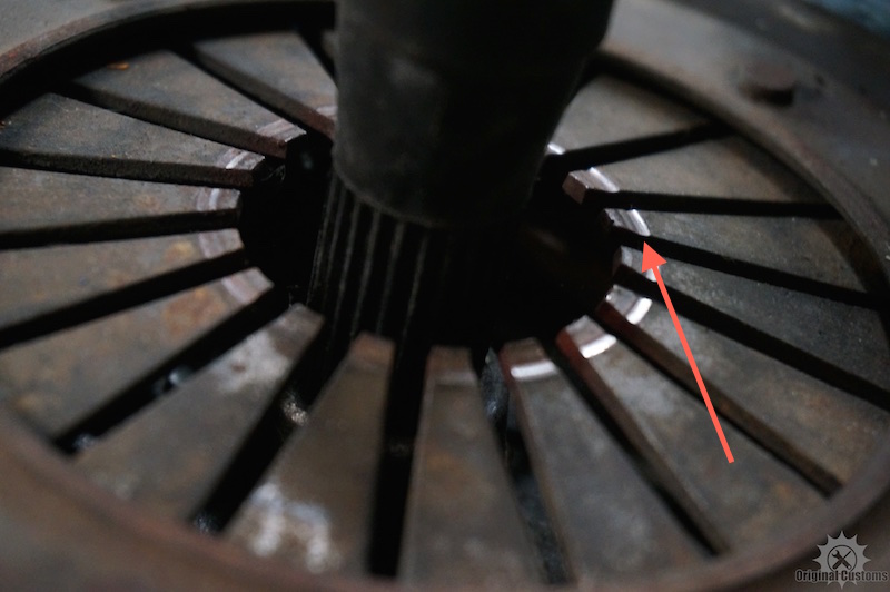

Hey guys, check my logic here. I see this type of grooving all the time, on nearly every pressure plate I see - regardless of engine type, horsepower, etc. I hadn't given it too much thought other than, "I don't like it, but it happens every time." But I was just talking with someone and it occurred to me that this might be wear caused by a bad throwout bearing. If the grease is sticky, or if dirt has infiltrated the bearing, it may not be able to rotate/spin correctly and would slip causing wear.
The point of the throwout bearing should be to stop exactly this type of wear, right?
Doest this mean bad throwout bearings are super common?
Or is this a symptom of a loose clutch cable, not holding the throwout bearing tight to the fingers and that lets them slip?

How many miles are on that PP? What type of driving? Mine is in the same (worse)shape and I was also wondering this same question...

I always understood this was the opposite of a loose cable. I thought ideally your throw out should hover just out of contact with the pressure plate fingers to avoid premature wear to both the bearing and the pressure plate springs, but since many cars have their clutch cable too tight, you get this.

That looks pretty bad
I see two forces happening here. One is rotational. If the bearing is stiff (or frozen) then there will be some slippage maybe only at first contact. The worse the bearing the worse the amount of slipping. The other force is the bearing being pressed toward the engine. Even with the throwout bearing operating properly there will be some sliding of the bearing moving in and out on the fingers. This will cause some wear. I don't think there is any getting around that.

Looks like a real lot shifting, a too tight cable, or a bad release bearing. Not sure what any manual says, but I've always put a very light coat of grease on those fingers.

It happens to all pressure plates, regardless of car make or year.
The sun should outlive the plate itself. No point in investing efforts here.

This is one reason I have been taught in the past (I'm talkin' long ago) that the only time you should dis-engage the clutch is when sifting gears. When I come to a stop light etc. I shift the trans into neutral rather than sitting with the engine idling with the clutch dis-engaged. I used to have a 1960 VW bug (I'm talkin' long ago) and instead of a throw out bearing it used a block of graphite that rubbed against the PP to dis-engage the clutch. When the graphite wore down, the metal cup it was housed in would grind a groove in the pressure plate. The less time you held the clutch pedal down, the longer the graphite block would last.

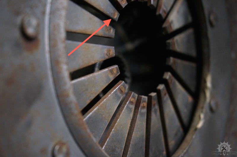

356 Pressure Plate of unknown age.
Click to view attachment914 Pressure Plate of unknown age.

Do you have photos of the throwout bearing?
What does the bearing surface look like?

This kind of wear is exceedingly common--maybe universal? I don't know why, because it seems to me that the T/O bearing should be there to prevent that. Especially if the bearing is always in contact with the fingers on the plate, so it should not have a chance to slip.
Maybe it would be worse without a real bearing in place?

So my question, the PP picture in the first post, is it usable?
I ask because I'm the one that sent it to McMark wondering if I should use it for my 3.2 or buy a new one. It's a kep stage II.

I just changed my fifty plus year old original pressure plate in my MGA...the fingers were worn but not grooved. My guess is bad TO bearing.
The bearing in the A was definitely worn but spun freely...the face was worn in a matching pattern. The bearing should ride gently against the surface as pressure dictates...nothing more.

If the tip of the fingers break off, what happens, anyone see that?

Google images shows some of these with broken fingers, so it does happen. Worst case scenario you lose some or all of your ability to disengage the clutch. Then you get it home, pull the transmission with the engine still in place, and swap in a new pressure plate. If it were my personal car, I'd run it and plan on swapping it out in a year or so.

Fingers broke on my son's Kennedy pressure plate just recently, but we think from a cracked diaphragm, not from common wear. If it fails it will make noises, won't disengage, and you'll know it ahead of time.

How soon....are we talking 5000miles, 50,000 miles.
Thanks
Jeff
Thanks, appreciate the input, I guess I'll plan on using it so I can get my car back on the road. Then I'll just have to start saving up for a new one, maybe change it next winter......if it makes it that long
my throw out bearing is fairy new, so that may help....and no riding the clutch pedal.
edwin
Dec 11 2014, 01:57 AM
Most clutches that I've replaced have looked like that at the end of their life.
I replaced one in the Saab I drive that had lost about a third of the fingers at the end. The big problem in that clutch though was that the driven plate came to pieces.
Worth looking at newer cars and how they run their concentric slave cylinders now. The bearing is designed to be in constant contact with the pressure plate. Throw-out bearings are typically a high clearance design and engine speed is hardly going to worry a bearing designed for 15krpm max. What kills bearings inside their design range is shock and pressure. The shock of a bearing coming from nothing to engine speed every time you touch the clutch will wear it faster than it resting lightly against the pressure plate all the time.
I really need to find the time to finish my concentric slave to replace the pull type I'm using now.
