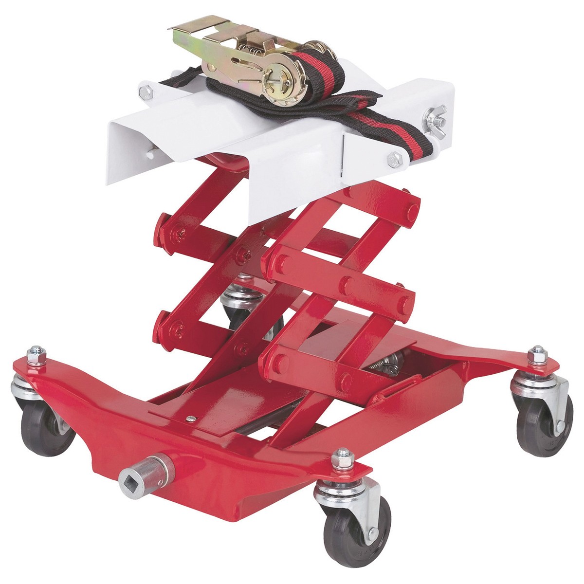

I used this... Harbor Freight Tranny Jack
I have only used it to pull the engine and trans together. But I know it would be an even easier job for just the tranny.
They go on sale and they have coupons ALL THE TIME. Best deal might be around $70.

I used that exact trans jack when I did it.
I held the engine with a floor jack while I removed the trans with that.
Then I took the trans off I put that trans scissor jack under the engine and tipped it back up a bit for storage.
Sat that way for a few months.
Then when I put it back in it went it so perfectly - POP that I had to stop and wonder if I forgot the clutch disk or something...
