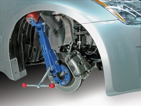

It can be done with a baseball bat, or a dedicated fender rolling tool.
Eastwood carries one.
IPB Image
http://www.eastwood.com/ew-fender-roller-w...36dUaAsqq8P8HAQ

With new paint you need the hot air gun, and the fender roller is made in China so you should be able to find one on eBay Sweden. The bat method is not as clean or precise, the roller allows for baby steps. $75 US is a small investment and you can rent or sell it after or find a rental.
youtube has many vids of the process.
