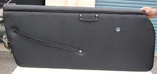

I recovered my door panels today in red basketweave to match my recovered dash face. The old panels had the cut out for the door handle, but before I cut into my newly recovered ones I was wondering how easy it would to make my own leather door pulls, like these ones I saw on a set of panels off ebay:
IPB Image
Has anyone done this themselves or have any pictures of how the strap attachs to the door opening mechanism?

A few people claim to have done it but I have not seen any photos of the modifications that are necessary to make the door open. For the trim pieces to work the new linkage needs to be inside the door. I made up the linkage but I'm not happy with it yet.

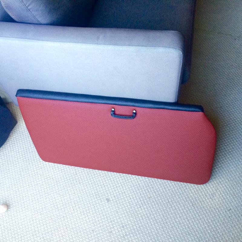

Hi Cairo, here's a pic. I think the line between the black and the red could be a little cleaner, but I'm pretty pleased with how it turned out.
IPB Image

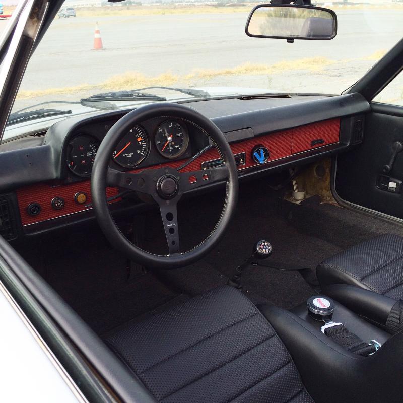

I always loved the red/silver combo on early 911s, that's what inspired me. I didn't want to over do it though - while I think full red works on a 911, I wasn't sure about a 914 - the only other red in my interior right now is the matching basketweave dash front.

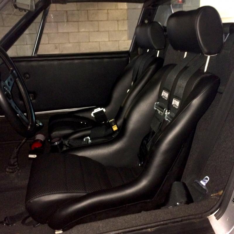

What seats do you have in the car, thats my real burning question!

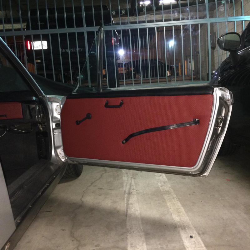

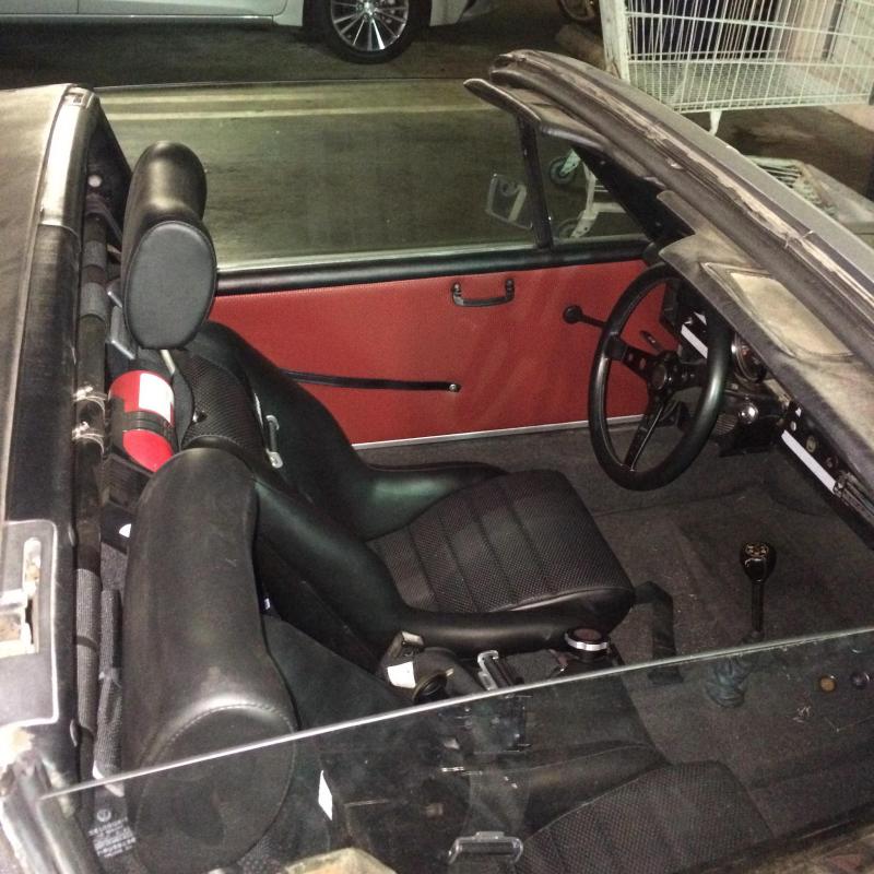

Ended up getting all the parts for the door pull from Bob at appbiz (alas, no bezels). Two leather straps with eyelets and all the hardware necessary to mount the pull and the plastic handle into the door. It meant drilling 3 holes to mount Jack nuts but was pretty straightforward.
IPB Image
IPB Image
I will try to post a 'how-to' in a few days, if anyone's interested.
