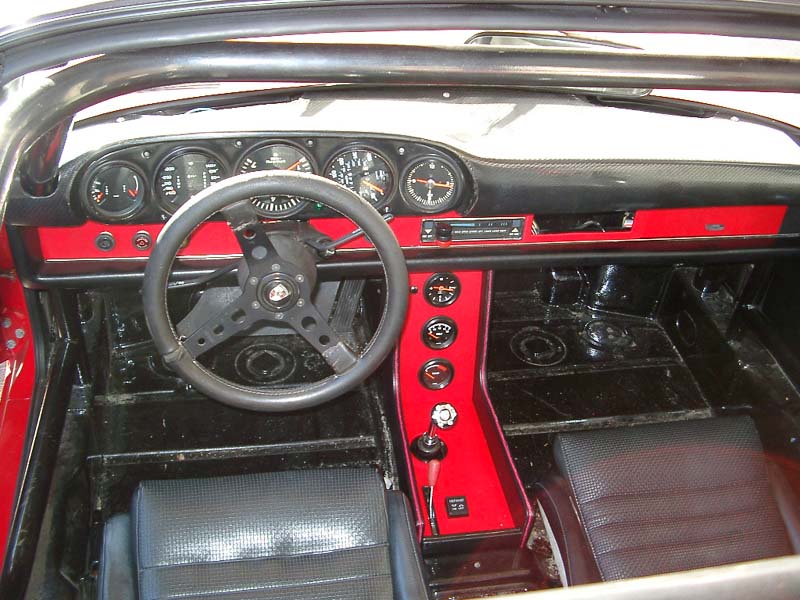

anyways......some people do dig them, here is a thread that SirAndy started about his:
911-ish dash
Mueller
here you go....
user posted image
