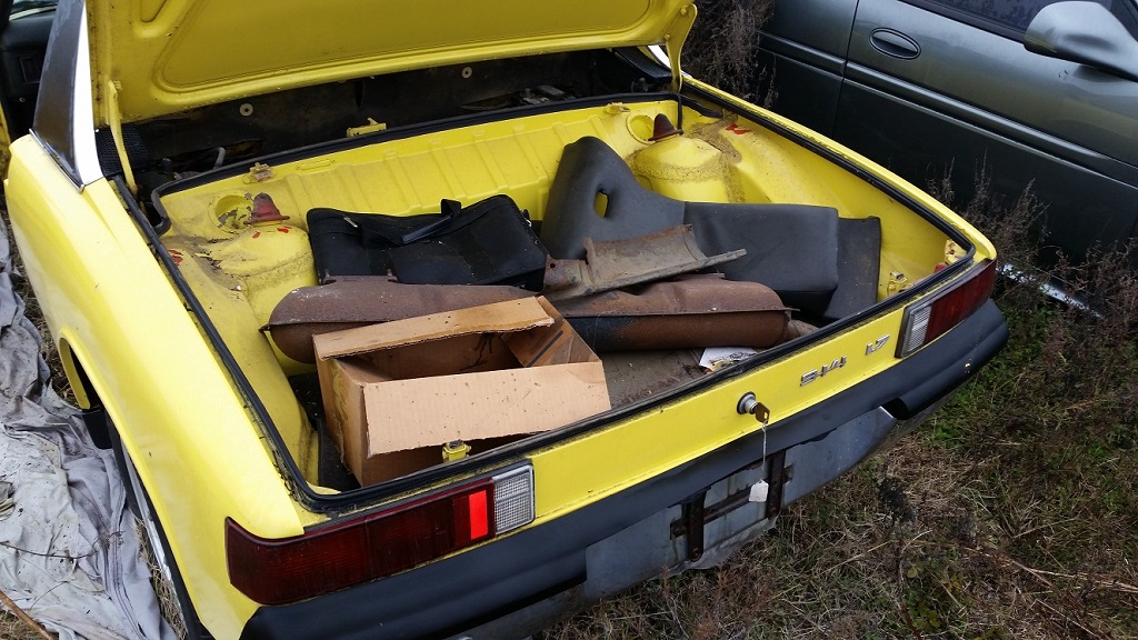

I couldn't figure out how to unlatch the front trunk (I used the key and pulled the knob under the dash, but it still was stuck on some latch).
I got some photos of the rear trunk, I'll post them up soon.
The next time I check it out I'll take out everything from the cabin and trunks to get a better look.
The engine and transmission was sitting in the shop. I don't really intend on using them as I would like to do a Subaru swap (I know I'm getting ahead of myself here). The engine and transmission are included in the price though.

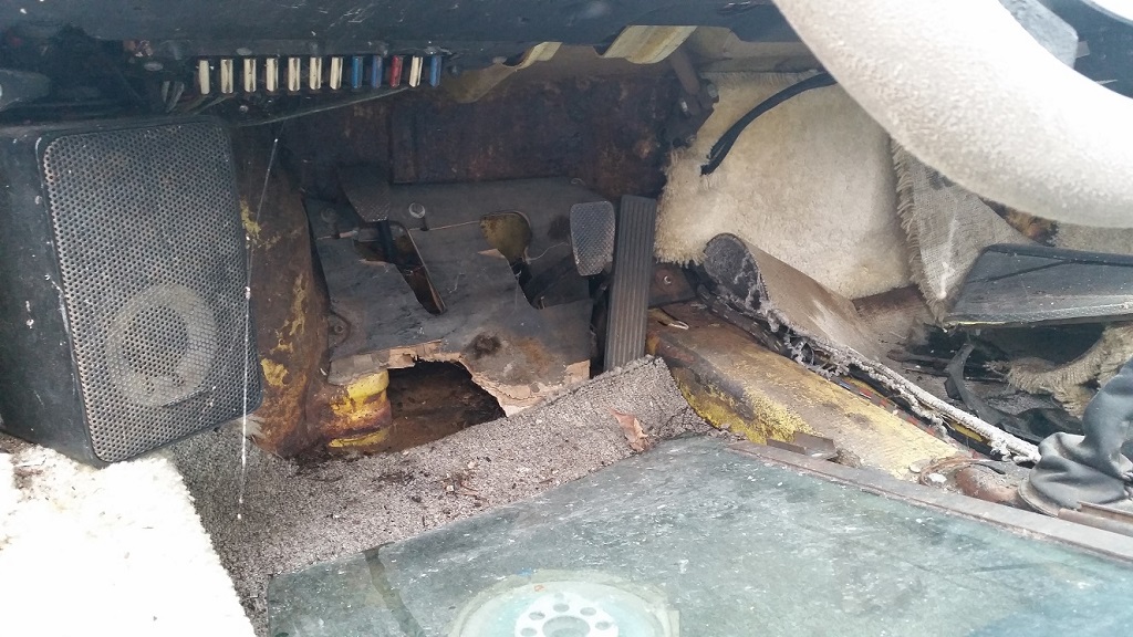

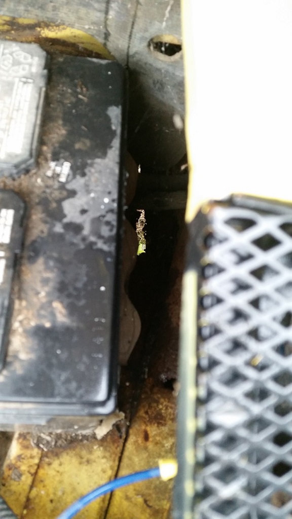

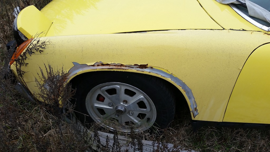

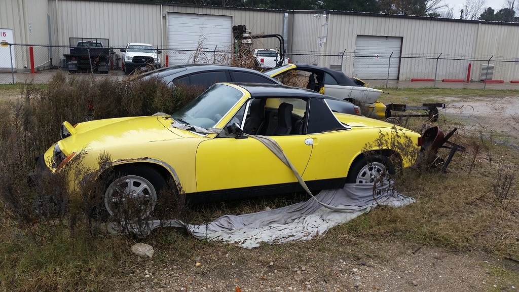

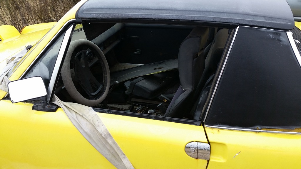

SLCE30318is
IPB Image
IPB Image
IPB Image
IPB Image

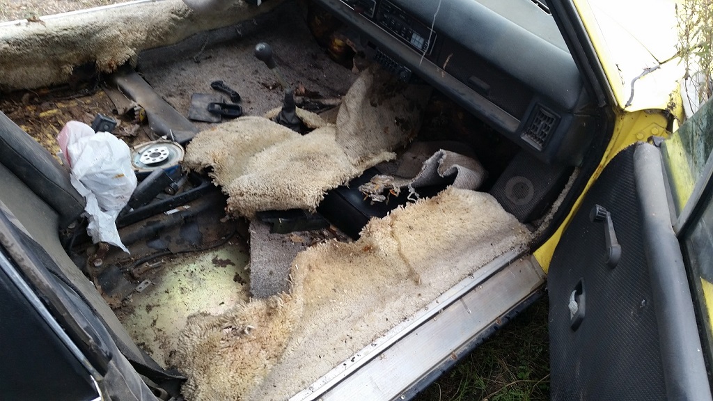

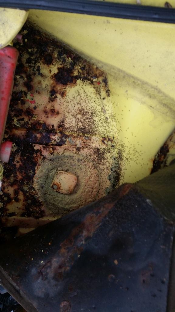

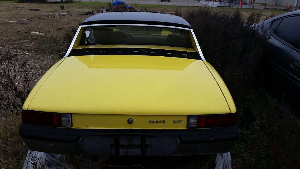

SLCE30318is
IPB Image
IPB Image
IPB Image
IPB Image
IPB Image

So it is a 73. Door gaps didn't look bad, dash didn't show any cracks in the video, has fuchs, didn't see a rear sway bar on the video.
It will need floor pan work for sure. Take the shop owner up on his offer and get it on a lift. You can get a better look at the rear suspension area. Check the bottom of the doors, get the front trunk open, you might need someone to pull up on it while you pull the handle from the inside.
For me not a $1800 car, but if the rust in the longs / suspension area is not bad then $1000 seems about right to me.
Oh and bring cash, I have closed many a deal on parts / project cars well the below asking price because I was a cash buyer WITH cash on me.

You can clearly see the ground in the picture of the battery tray which means the passenger side long is COMPLETELY rotted away.
I'm afraid this one is terminally ill ...

I concur. Cost to repair correctly likely exceeds finished value of the roller. IMHO.
But . . . What size is the engine? Looks like a nice parts car.

You don't need to look for rust. It's already there. Its a good $1k parts car but will probably become a very frustrating and expensive restoration. However, a parts car is a great way to get a 914 education.

Indeed the dashpad appears intact,tlc needed.The car appears to have been originally red judging from the overspray.

So the battery tray area looks pretty far gone. But I'm still holding out the slightest of hope for a steal and long restoration.
I can see grass through the passenger long. It's toast.

The nice thing about getting one like this, assuming you intend to disassemble and inspect every part and then put it back together, is you will know exactly what the car is made of and where the issues lie. Since you seem to be looking for a project that may span a few years, this is not a car to run from -so far.
Take the shop owner up on his offer and put it up on a lift and really poke at the bottom of the car so you can see how extensive the rust is. Then you will know if your top offer is <$500 or not.
