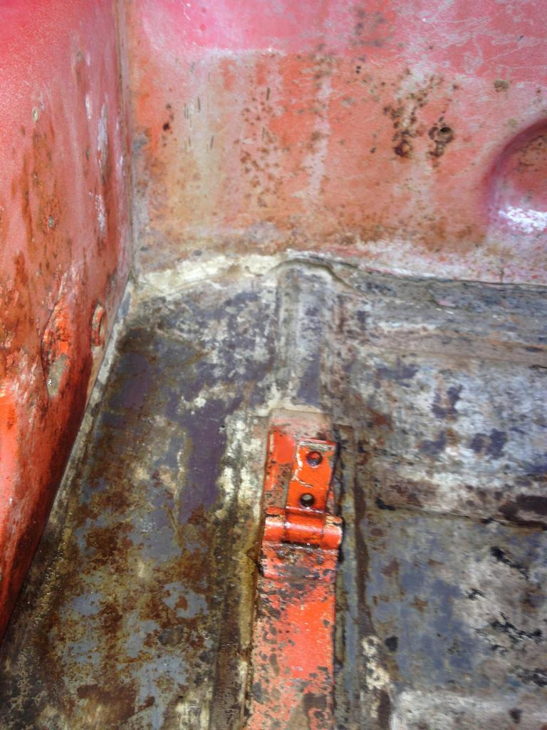

Here are some shots of the steel.IPB Image

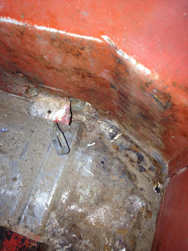

76-914

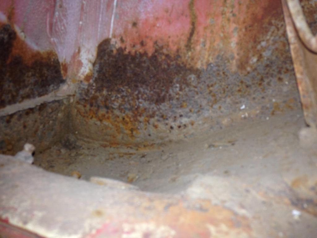

Assess the body repair first. That jack point is not all you'll find. That corner area beneath the batt tray looks suspicious also. Take a pic from the top looking down into that corner. Poke around with the ice pick if unsure. With power upgrades come chassis upgrades. Suby is a fine choice and makes the car "very affordable to own" as well. The EG33 is a proven design and readily available. There may be some issues with Cold Waters cradle and the EG confused24.gif It is the heavier and larger of the Suby 6's. Chris H. as well as Bigkat83 here, have done this conversion and might be of help.
914GTSTI

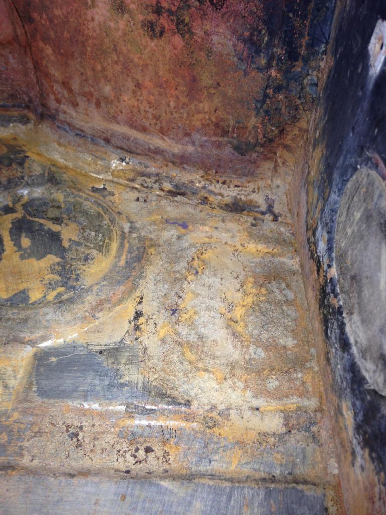

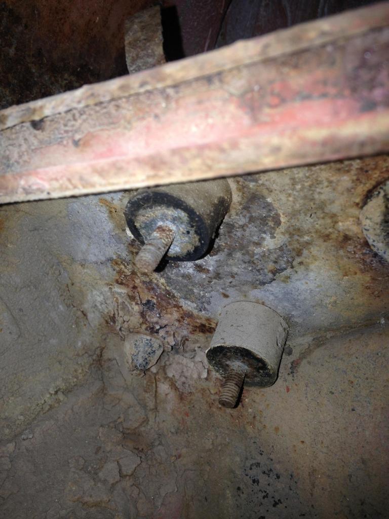

Will need to get a shot of the passenger side battery area.

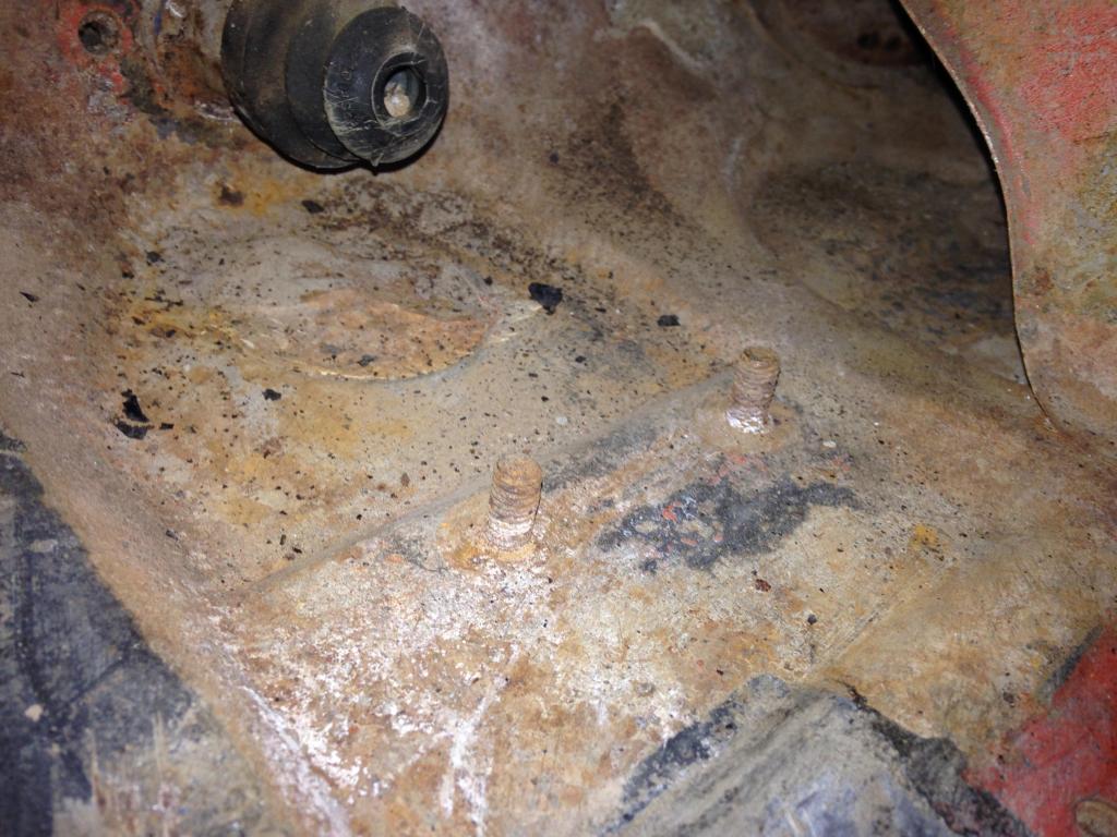

Their are some small pin holes at the driver side rear,outer floor and passenger side front,outer floor.
IPB Image

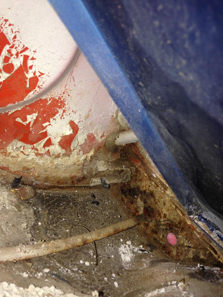

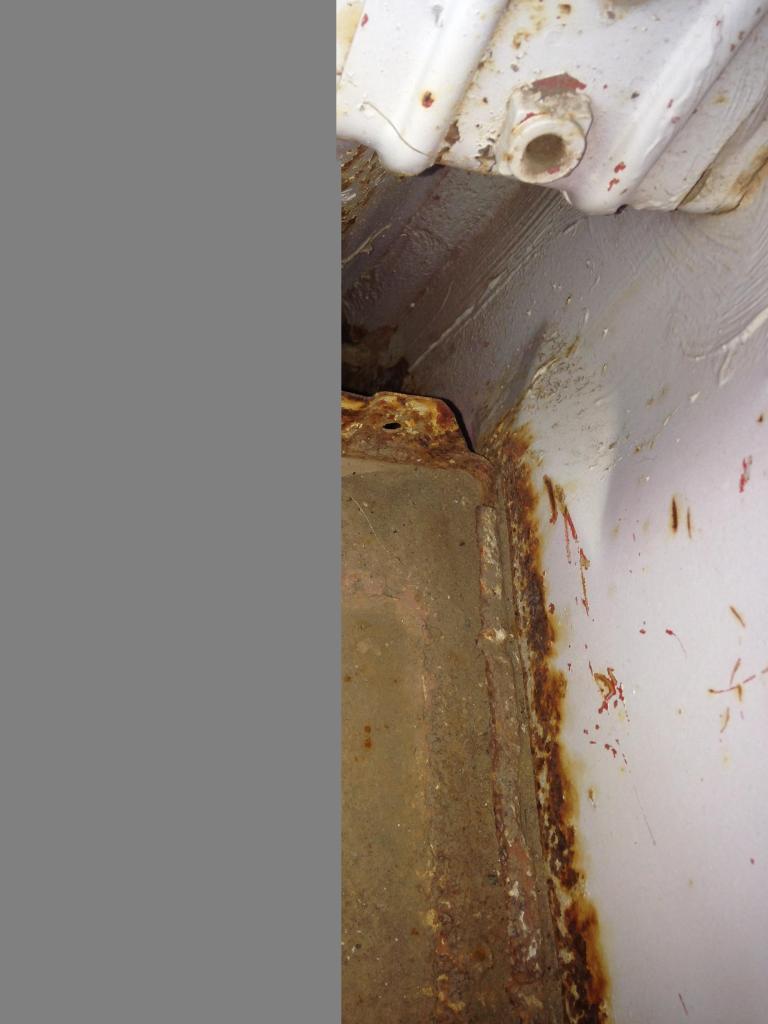

Hell hole ??
IPB Image

rick 918-S
Nice car to start with. Check that suspension ear carefully. It looks cracked but could just be the paint.
914GTSTI
Thanks,Rick. I'm hoping it will work ? So good so far .
Yep,the white paint is coming off in big flakes.
Randy
rick 918-S
QUOTE(914GTSTI @ Jan 25 2015, 09:17 PM) *
Randy
Ya, made the ear look cracked in that photo. There is a few issues but there are guys here that are drooling right now. Get busy. My suggestion, don't make a big project out of it the first time around.

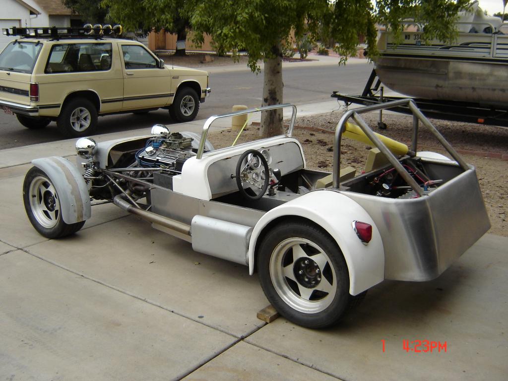

Like this ?
IPB Image
Locost 7 from scratch using 5.0 and T5.
Thanks,Randy
