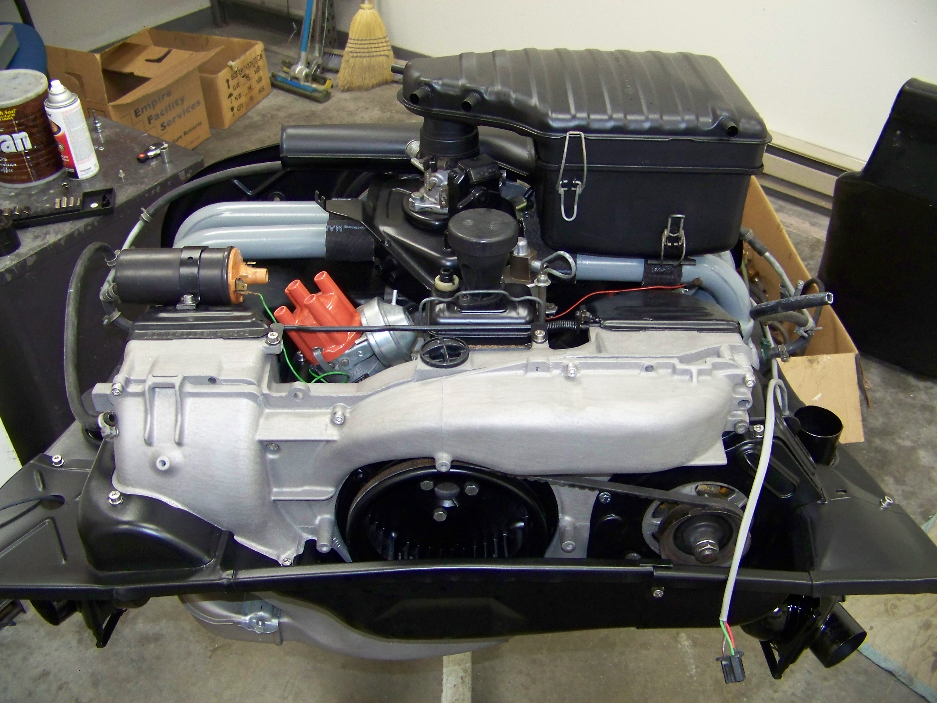

Block torn down in Raw form.
sda4property@gmail.com
Engine done.
New Starter & all parts, New everything..!
OVER BUDGET = Worth it..!
Dave_Darling
--DD
We still have time to get it right.
I told the guys to go nuts & they added one too many new parts.
The mechanic can pull that aftermarket part off before the motor goes in.
JeffBowlsby
That alternator harness looks pretty sketchy too. They always fail right where they pass through the tin...do you see any exposed metal wire in that area?
Bleyseng
QUOTE(Dave_Darling @ Mar 12 2015, 04:16 PM) *
--DD
yes, but using a Bus screen sure keeps the crap out of the fan
