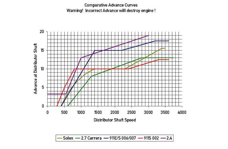

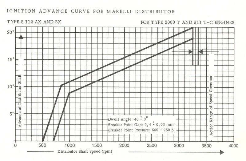

Not at home so these are not the best graphs, but:
This is a Marelli from some version of 2.0T:
This is a bunch of other types shown together:
messix
soo.... it looks like even the worst one is all in by 3500 rpm, so why rev the shit out of the engine? just because it sounds cool? idea.gif

You're 2 for 2 in wrong-ness. These charts are distributor speeds, which are half of engine RPM.

QUOTE(mskala @ Mar 18 2015, 07:14 AM) *
QUOTE(messix @ Mar 17 2015, 09:40 PM) *
so you really have to run them up to 7,000 rpm to make sure that it's all in!

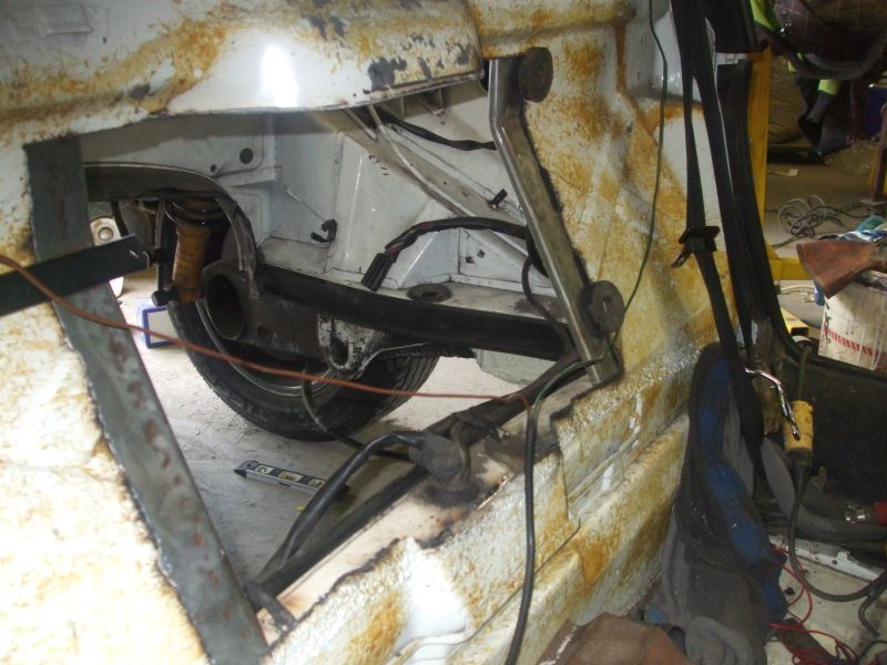

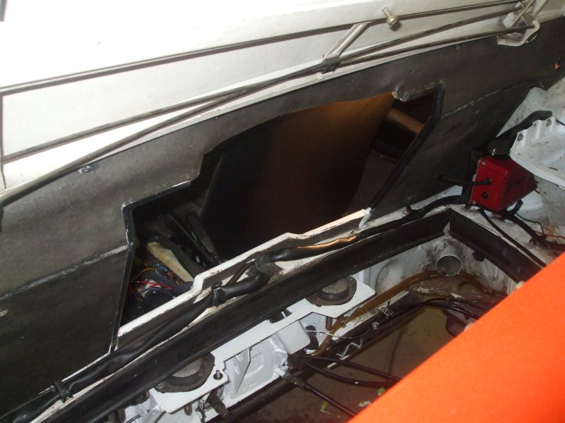

IPB Image
IPB Image

QUOTE(Mark Henry @ Aug 13 2018, 02:15 PM) *
IPB Image
IPB Image
I know most of you don't worry about it, but I have a really BIG problem with cutting a hole in something called a FIREWALL. I watched Betty's 914 burn, and I am glad it didn't have a hatch.
Rand
Cutting a hole isn't a problem. Leaving one is. No reason an access panel can't be made as long as it gets closed up. Removable can be done properly.
