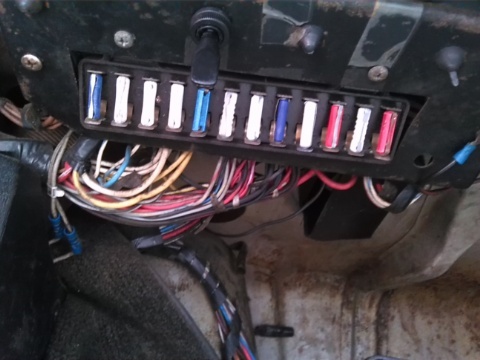

My car broke down on the way home, between pushing and jumping in and out I knocked out a number of fuses. It's not the first time this has happened, so they probably weren't right to begin with.
So, what amperage goes where?
1974 1.8ish

I guess I need to find some more 8a fuses.
