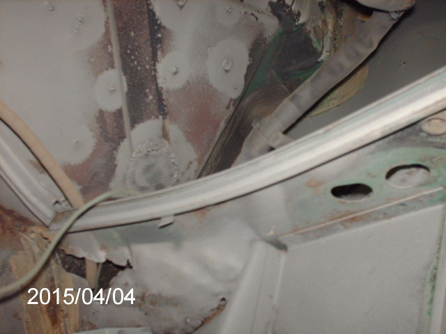

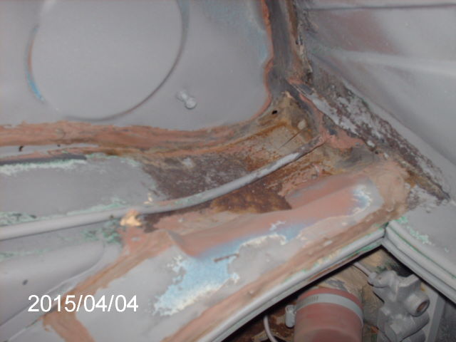

How hard is it to remove the engine shelf, and what is the procedure?

Previous owner (s) must have hacked around the area for some plumbing, or something, in the area of the drain hole, and so with the engine out, and sandblasted, I would have the body guy put in a new shelf. Maybe the passenger side to?
