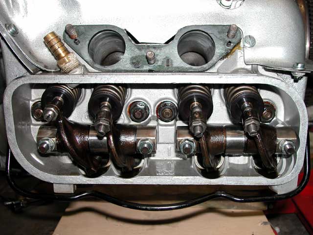

i have a head from a later car that had air pump. i have the hex head bolts (m10 x 50mm x 1.0 mm) to close the holes. should i use some kind of sealant on the threads?
the hex head bolts need to be turned to correct angle so as to clear the manifolds, which is good because they can not back out. what do you think i should do?

I'm going to be doing this as well but havent decided on a sealant. Maybe some high temp pipe sealant used in super heated steam lines. Just make sure that whatever you use will allow you to get them back out or you wont be able to remove the tin.
Bleyseng
Feb 20 2005, 12:40 PM
I thought you could use the 10mm valve adjusters in the holes with a high temp sealant.

can you just cut them off and weld em shut??
Bleyseng
Feb 20 2005, 12:50 PM
only if the heads are off, then you can have then filled.
You want to drill out and install the breather tubes, Dave or the backpressure will blow out the valve cover gasket and the pushrod tubes.

Oh that's great. I don't know how to add that. I'm assuming that there is a hose attached to it? Where does the other end go? Is it done on both heads?
Aaron Cox
Feb 20 2005, 01:22 PM
QUOTE (Headrage @ Feb 20 2005, 12:19 PM) |
Oh that's great. I don't know how to add that. I'm assuming that there is a hose attached to it? Where does the other end go? Is it done on both heads? |
yes. and yes. drill and tap.... put a hose on. on a carbed car you vent it to the carbs or to a breather box....
the joy s of smog heads

you can vent the valve covers if that is easier for you.....

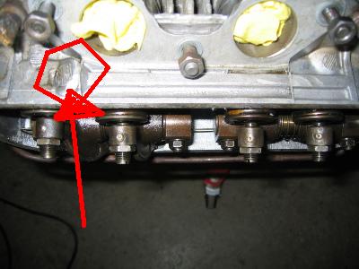

Allen- to not hijack this thread any more I posted on a thread that I started in December regarding the head breather question.

thanks for the input to all. you are right about the breather hose on that side, i can still do that and was wondering if it would be an issue. the engine is assembled so welding it shut is not a option. and taking the tin off someday would be a good idea so i'm still thinking like some lock tight,heat may be a problem (with lock tight).
