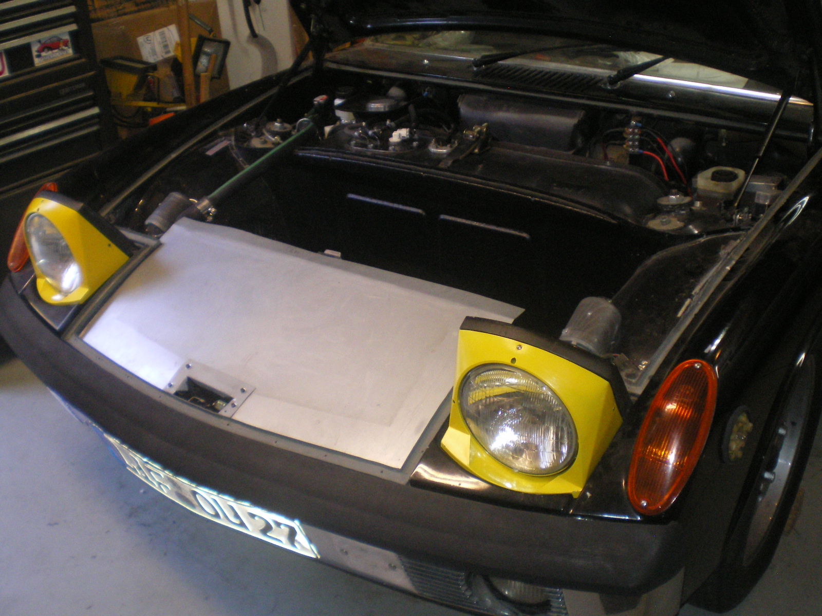

I too have and use driving lites for daytime visibility. I believe this mod is more effective as I see drivers heads turn as we pass. I don't expect anyone else to paint these Yellow but "Kugel" is modified anyway. Anything that makes them see ya.
