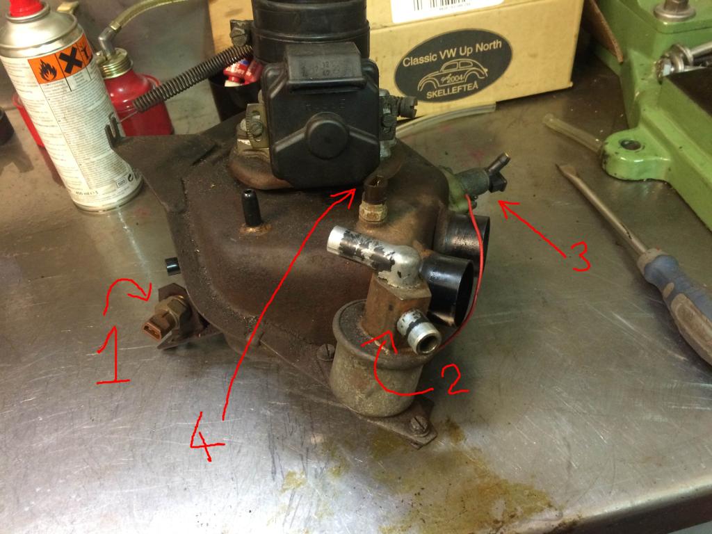

I may be mistaken but isnt the cold valve #3 on the pic. Only one input?
IPB Image

The L-Jet has two ports, Maybe he thought you had L-Jet Fuel Injection.
r_towle
ok, so its one port.
remove the t-connector in the fuel line.
OR, just simple plug it.
The objective is to stop putting any fuel at all into that injector.
