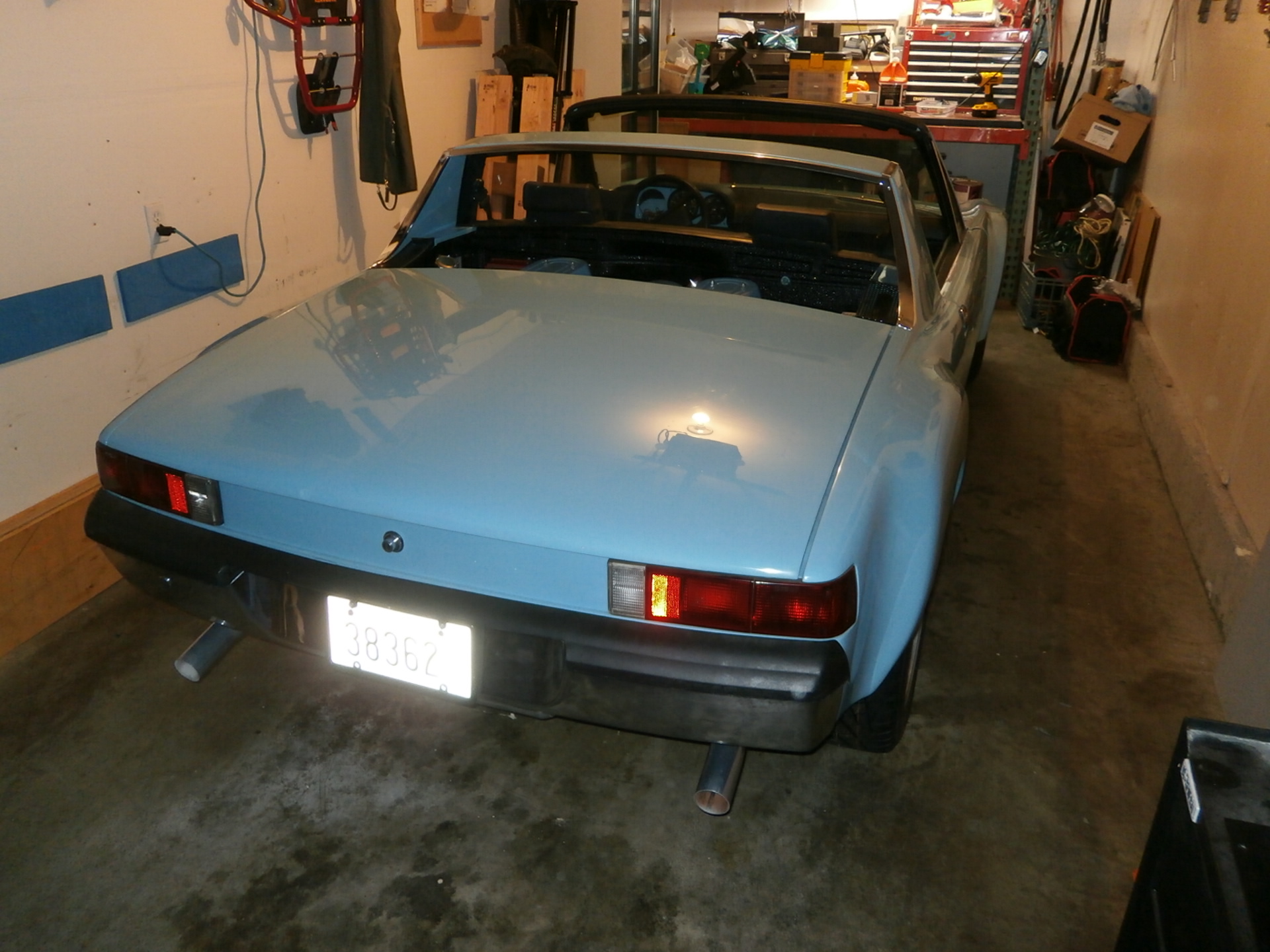

PanelBilly
Its off the stand and on the ground.
