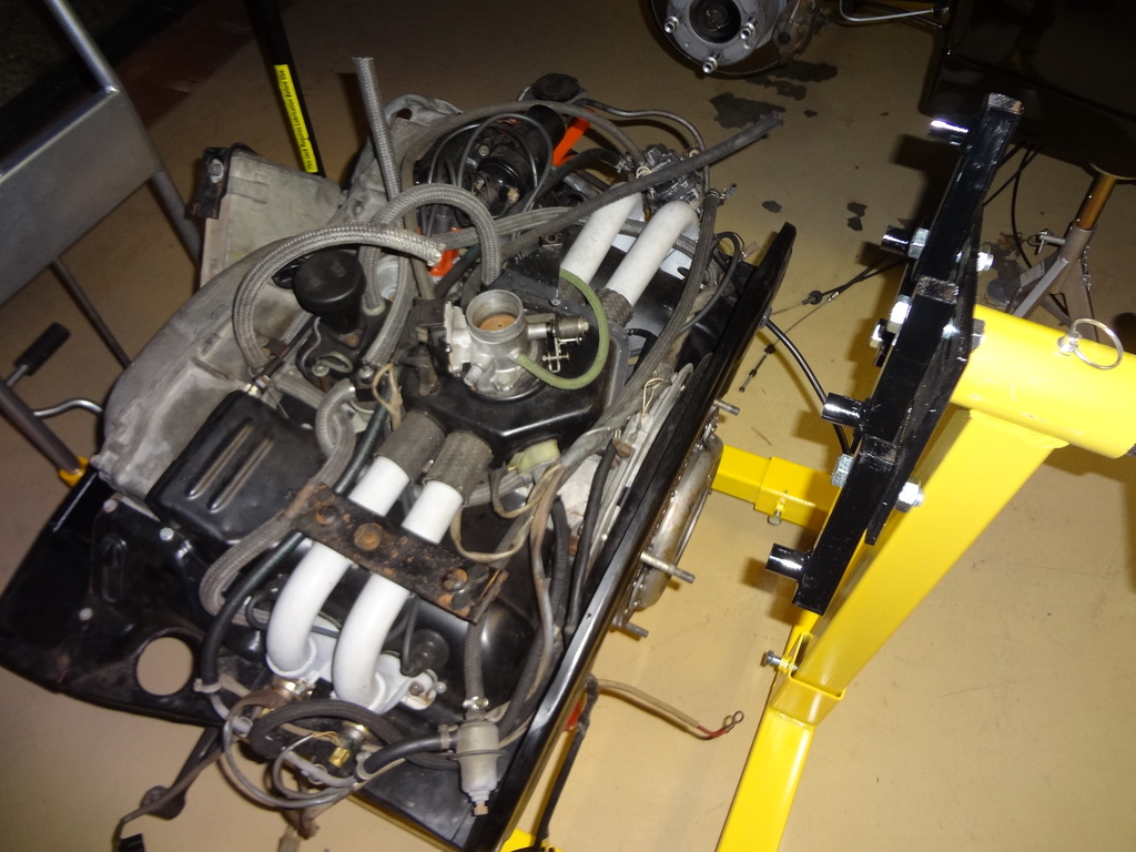

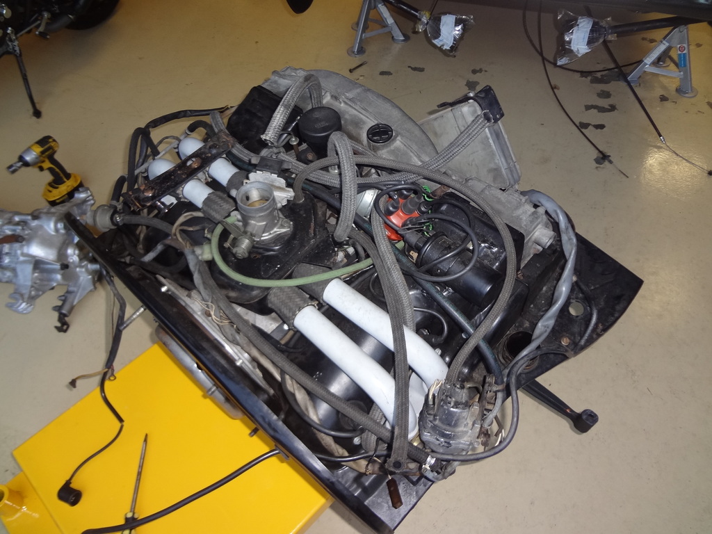

But this is the first time I have used an engine stand... is the normal convention to remove the engine tins and the clutch assembly first??
Also, I have drained the oil earlier, but when it is on the stand, and I turn it upside down, is it a bad thing for any residual oil to head to the top of the motor??

TheCabinetmaker
It will not hurt a thing. That's a clean looking engine.

EdwardBlume
You'll enjoy rotating it freely. Oil will come out, but usually when you've stepped away or left for the evening, so you find it on your engine stand the next day.
infraredcalvin
You should be able to mount the engine to the stand without removing anything other than what is shown in the pictures. EDIT: I just noticed the standoffs are pretty short on your stand, you might have to remove the PP/clutch disk to get a flush fit.
Orient your mounting plate and arms similar to how the Porsche/vw engine holding fixture would mount. Those are designed to build a motor all the way up from a case half. Think about the tools you have and how they might fit (or not) to remove PP/clutch/flywheel if you need to get back there.
I bought the Porsche engine adapter and used on a standard eng stand like yours to rebuild the top end of my 930 engine. I had to install the clutch/pp after it came off cause there wasn't enough room to use the clutch centering tool, other than that, was really convenient, and easily held the weight of my fully dressed engine.
