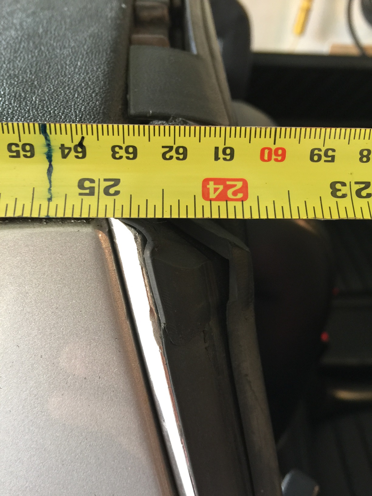

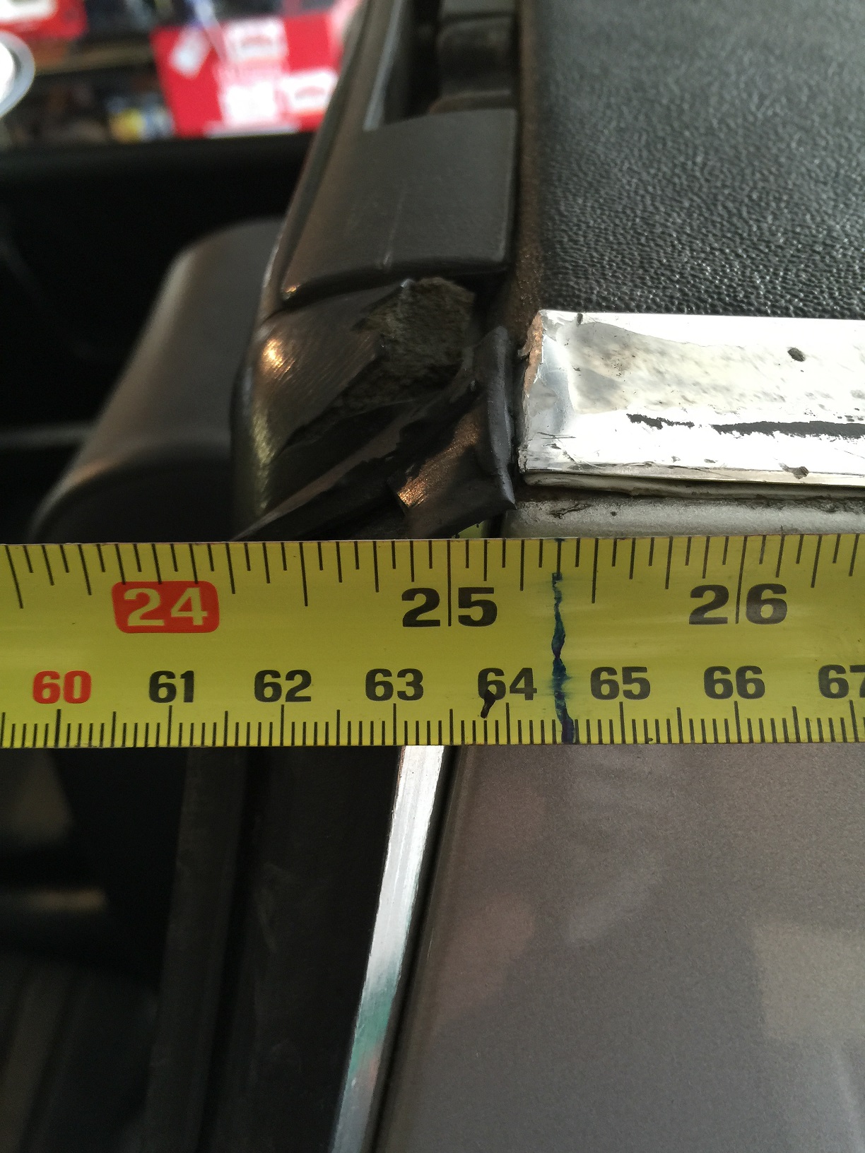

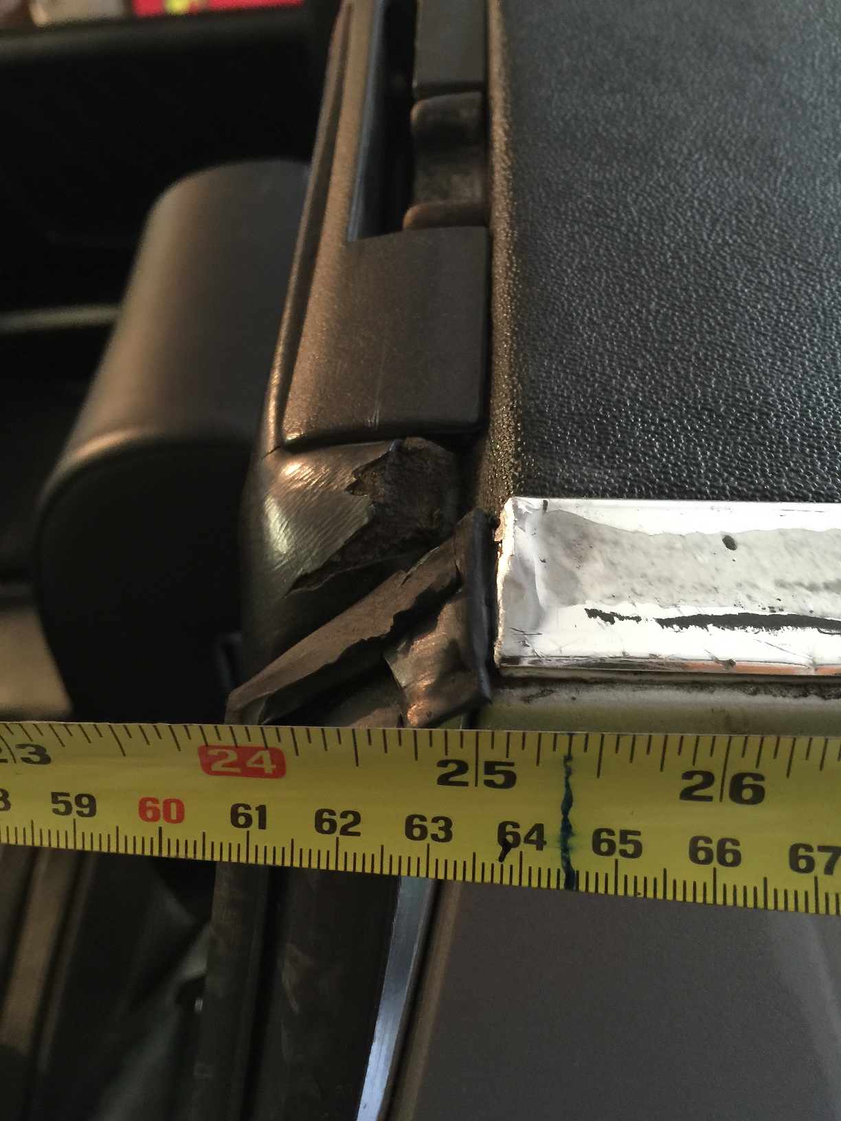

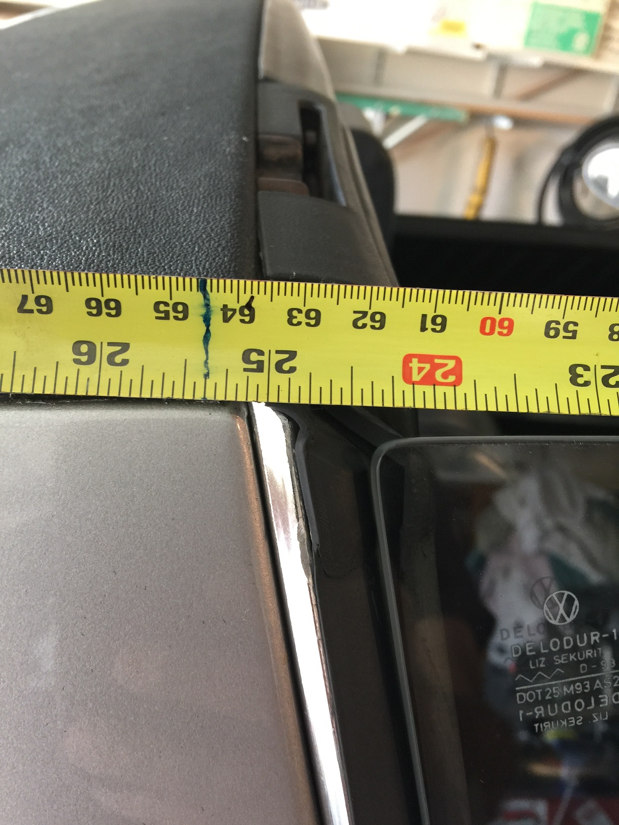

What is the consensus on flex regarding the roll bar to windshield flange measurement?
Item "F" on the body dimensions page.
http://www.914world.com/specs/bodydims.php
My car was fine until I had a shop weld in the Engman long kit. The car is much stiffer, but the windows and top no longer fits right when the car is on the ground.
On the lift I get 25 1/8".
Off the lift I get exactly 25"
How much should the car flex when on my scissor lift versus on the ground?
The scissor lift is using the four jack pods to raise the car.
Should the car be like 25 1/4" on the lift and 25 1/8" on the ground?
Is 1/8" flex normal? What is everyone else seeing?

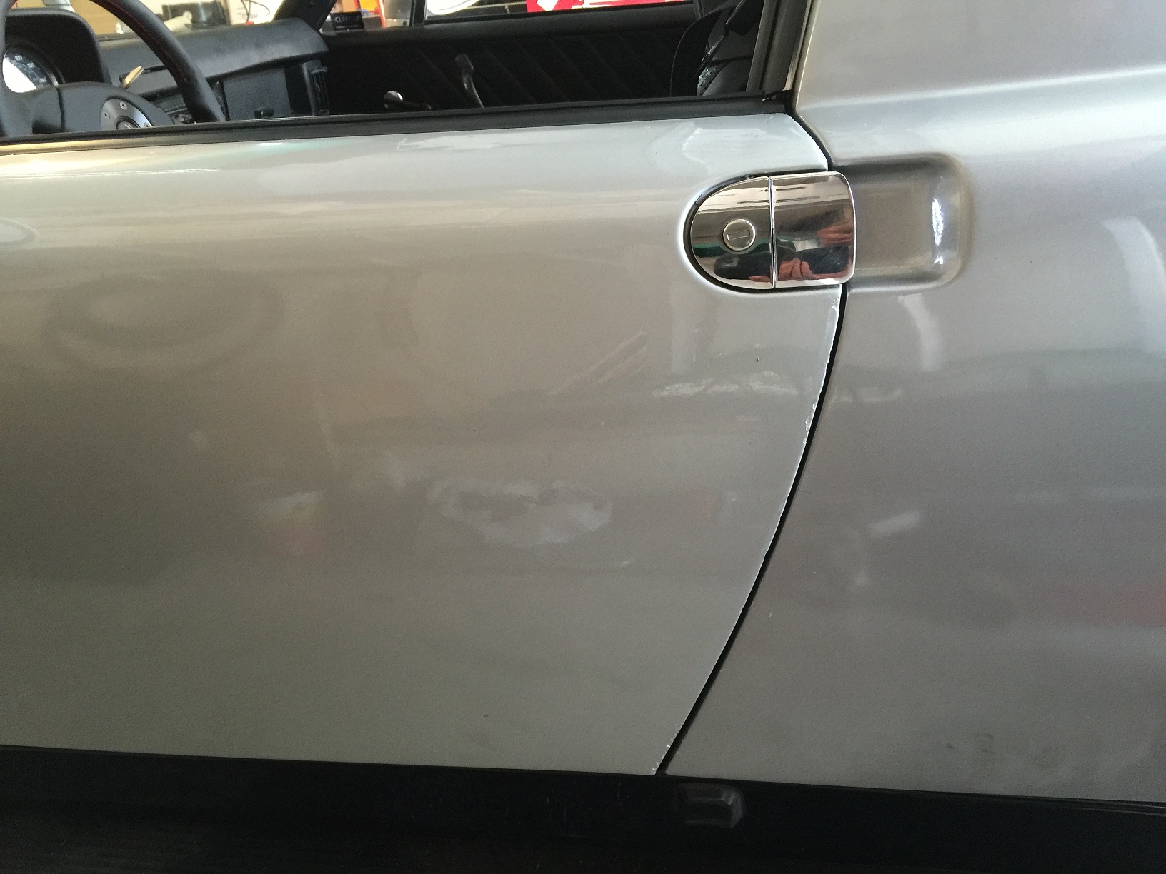

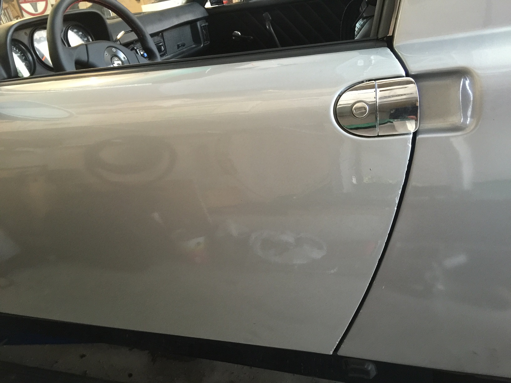

Steve
Door gaps on scissor lift
Passenger side
Drivers side on scissor lift

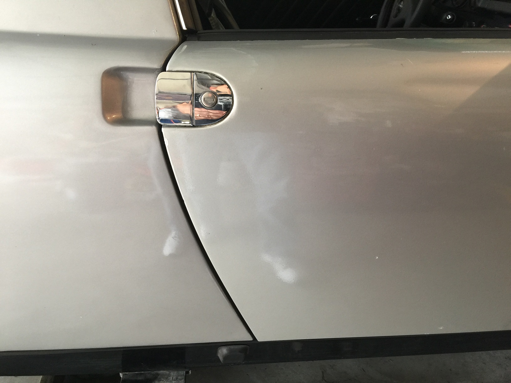

Steve
Door Gaps Passenger side on Ground
Door Gaps Drivers side on Ground

The Engman kit does nothing for sag. It will assist slightly with torsional twist introduced more from the hard corner loading in the front suspension vs the opposing forces from the mid-engine weight.
Your issue is at the base of the "C" pillar at or just rearward of the jack post. Remove the rocker covers and fix the rust or fatigue in the chassis. Engman does nothing for that.
You need to go deeper now to see if the chassis was twisted during the welding process.
You need to think about this in 3D. F and X are good. Y and G will tell a different story. G will tell you side for side if someone over time bent the windshield frame up or down to get a fit to the window frames or targa top. Y will be a more accurate measurement than X because the windshield frame is easy to bend out of place.
In most cases we are checking chassis' for sag from rust damage not collisions. So if you get a good G AND the door fits the front fender line AND the windshield frame fits the vent window,
(set the frame to spec, fit the door to the fender, adjust the vent window frame to the windshield frame)
Then you will be able to have confidence in your F and X measurements.
At that point you can address the sag at the jack post, install door opening braces and fix the soft chassis causing flex.

Thanks Rick for the help!! Question.. Should there be any sag at all or should it always be 25 1/8" on or off the ground? Same thing with the other measurements?
There is no visible rust under the rocker panels. The car had a GT kit welded on 20 years ago and this problem came up after the Engman kit was welded in.

Looking at the top of the door gap pics it seams to me that on the ground it gets tighter. With that said I agree with Rick you need to start looking at your jack points for rust. You really can't tell just by looks but need to start poking around. If you find some soft/rust areas that needs to be addressed. Like anything fix one thing and something else will pop up.
On my 6 I have the same issue with the door gaps and jack points.
The pass side looked ok in some spots and in others it had some small holes. The more I dug the more rust damage I found. At the end I had to replace the hole area with new metal from RD parts # PP351 & PP331.

Without seeing the car it is hard to tell what is going on with it. But The last car I fixed was solid on or off the jacks. If you drive the car hard you may have some fatigue? You'll have to look further. are you able to change the measurement this way?
Place the car on jack stands level as you can. (not the biggest deal just so it doesn't rock on the stands. hold the tape in place have someone lift the rear bumper then try it on the front. Then try it corner to corner front and rear with a cross measurement. I want to know if it is the front or rear changing the measurement and if one corner is weaker than another. I'll be out today but Lets see that that develops.

Thanks Rick!! Great advice!! I will know more after taking more measurements. I will put the car back on the scissor lift and raise the rear with a floor jack and see if it changes and then try the front.
I will try all four corners. Sad part is I have all the carpet and interior back in. This might be something I just tolerate until the winter break.
