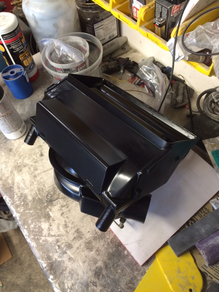

I've searched and searched, but cannot find a definitive answer. Is there an alternative to the factory clips that connect the upper and lower portions of the fresh air box? I somehow lost mine (despite my heroic efforts to bag/tag everything!). Below are some pics of what I did to accommodate a heat exchanger into my system...

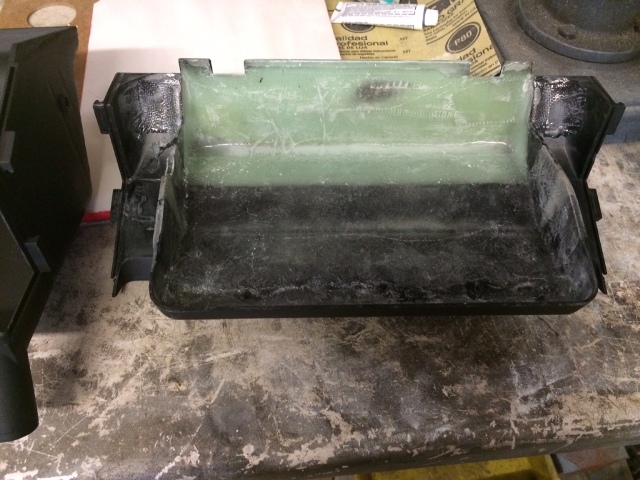

I had to add an "annex" burp-out to house the 1994 Mustang V8 heater core (5/8" inlet and 3/4" outlet) to the Behr air box. I made this out of fiberglass, and added a "pie-cut" to the water shield.
The next pic shows the "annex."

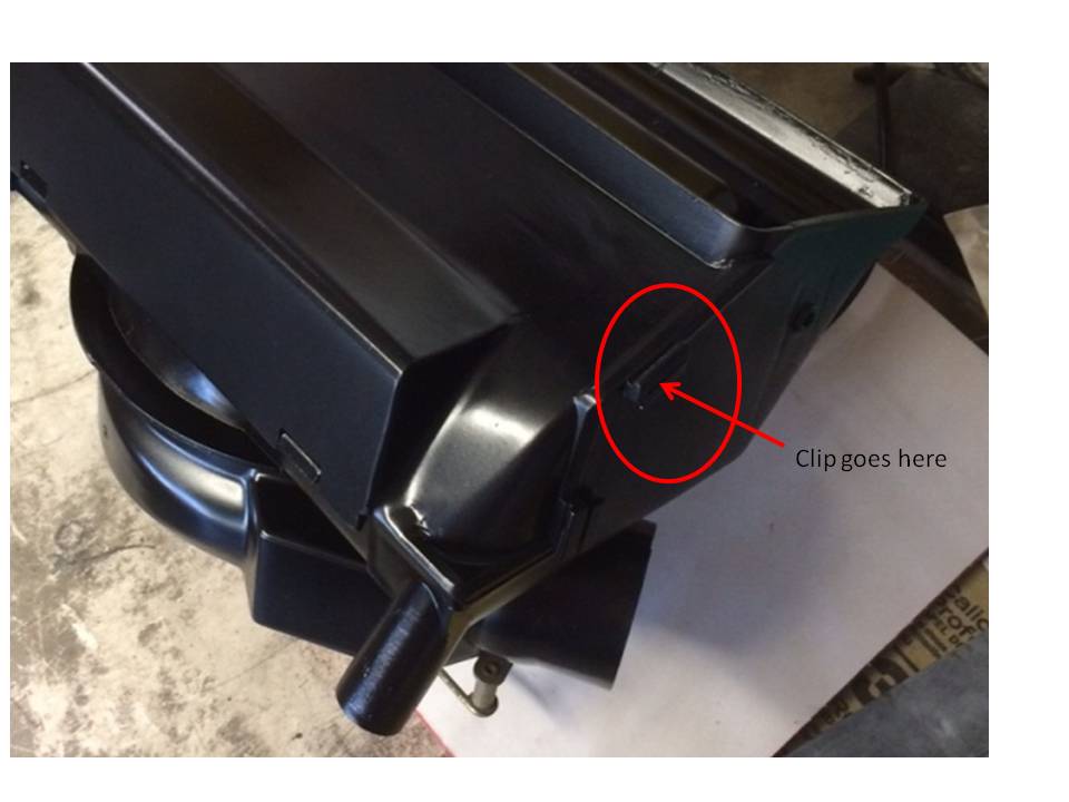

Oh yeah, I'm looking for four clips like the one that that goes here:
strawman
Elliot, I'll buy you a veggie sammich at your favorite Paso Robles deli and pay a pretty penny for 'em. Lemme know!
Elliot Cannon
If this is what you need, I have four you can have.
