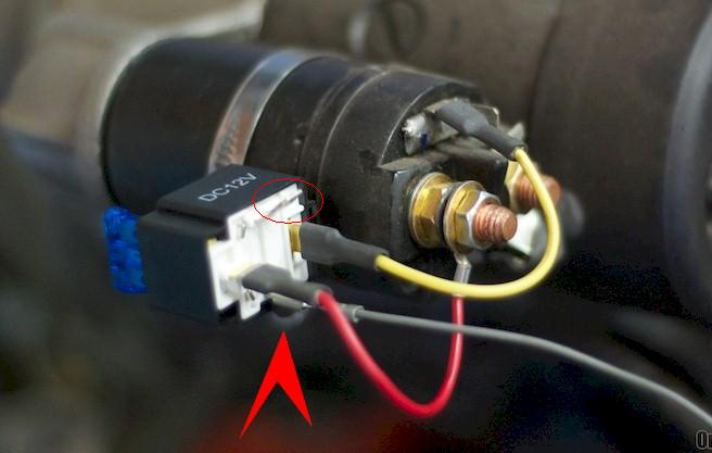

My current setup is:
Ignition switch (key) provides current to a high current standard 12v Relay.
This relay connects the Starter +12V (Big Red wire to starter from battery) directly to the Solenoid input.
I also use the high torque starter you can get on ebay.
You can see the setup (when still messy) here:
IPB Image
markb
This is what I had on my 72 for years & never had another issue. Simple & effective.

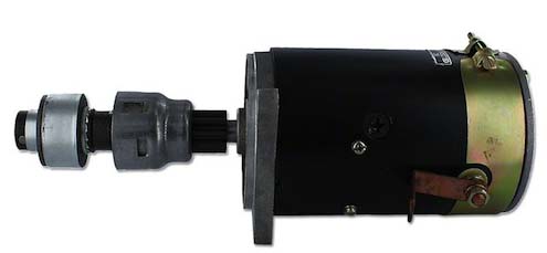

That is interesting. I bought a tractor part from ebay that I believe is the same thing. Only mine was activated by grounding the control connector. No go for the ignition switch. Except it was easy to switch it around because they are simple as can possibly be inside. Be careful though about whether you get a minus or plus terminal. Many have both, which is fine.
I was wondering about actually using mine though, figuring a new starter and all. This thread makes me think I should.

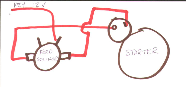

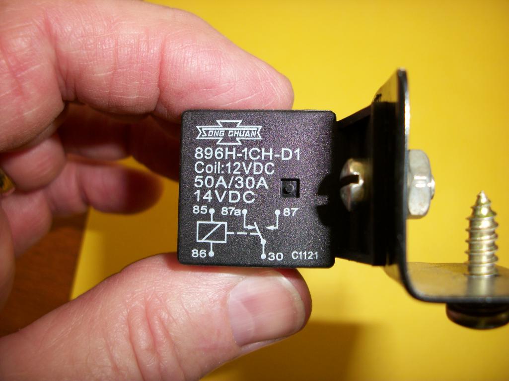

There are lots of relays out there that can be used. One thing I haven't noticed mentioned is the relay needs to be able to handle about 30 amps. That said, I have an American car, maybe it's a Ford, relay in my circuit.
Click to view attachment thanks to Mark Henry for the schematic!
Mark Henry
QUOTE(type47 @ Jul 3 2015, 11:50 AM) *
I've never found any of those relays to be as good as the Ford unit and just about everyone that knocks the the Ford solenoid solution were using a small bosch horn type relay.
The bottom wiring diagram is mine that I posted way back when this site started in 2002, thanks for the credit. laugh.gif

I chased that rabbit down the hole. Here's what I ended up doing. BTW: Thanks to Ed Morrow the best long distance trouble shooter ever! pray.gif
Finished up Sandy's car last year in time to drive to Moab for the RRC. Starter failed on the way home. It was fall so we put the car away until spring. Spring rolls around and I put a starter in from Orielly's. and headed for the Route 66 event in Palm Springs. Starter failed as I neared Vegas or... so I thought. idea.gif dry.gif Stopped in Vegas and picked up a warrantee starter and changed it. Worked for the weekend. Failed in PS. Left the car there and flew home. Came back a month later and picked up the car and it started. Got the WCR and it quit again. worked off and on all weekend and for the drive home.
Thought I just got a bad starter again. Picked up a Bosch re-man and swapped out the Orielly's unit. Worked but barely. Added a hot start solenoid, No Joy.
Called Ed, he say's take a jumper cable and connect it from your negative post to the starter. WHAM!!! it starts like new!
Cables were factory and looked clean and nice. Cali car with clean grounds, New braided ground strap.
I replaced the negative cable to the body and the starter still didn't work. I then replaced the positive cable and WHAM! perfect!
So my advise, Before changing anything us the "ED" test method! Then change the cables first, not last!

To summarize the various posts on the subject, the pictured Ford starter solenoid is redundant and thus overkill for the type of starter system on a 914. A HD relay is all that is needed to provide full battery voltage to energize the factory-mounted solenoid.
Most starter motor assemblies use a solenoid mounted on the motor with linkage to move the flywheel pinion gear into mesh with the flywheel while at the same time energizing the motor. Older Fords used a Bendix drive motor that moves the pinion gear without need for linkage, thus a separate solenoid to merely energize the motor.
<1964 Ford starter
The following is a link to install a remote relay on a 911 (not different). The purpose was two-fold; 1) to reduce wear on the ignition switch (NLA and thus expensive) and 2) to eliminate voltage drop and insure a full 12 volt source signal to the starter solenoid to consistently energize the starter. http://members.rennlist.com/911pcars/RemoteStarter.htm

The ford solenoid, ( in this case used as a relay ), is doing exactly the same thing as stated in the link you posted. Perhaps you misunderstood it's use.
Tom
screenguy914
QUOTE(Tom @ Jul 6 2015, 02:07 AM) *
Tom
I think you were directing your response to what I wrote.
You're correct in that the Ford remote solenoid does the same thing as a relay. However, it's designed carry starter motor current (e.g. 100+ amps), massive overkill to send a low current (3-5A) control signal to the starter-mounted solenoid. A $4 Bosch relay is all one needs to shorten the source path to the starter solenoid, but up to you.
Imagine using multiple Ford solenoids instead of round Bosch relays to energize the vehicle horns, turn signal system, fuel pump etc. It's like using battery cable to replace 14-16 ga. circuit wire in the electrical system. Again, up to you.

I've often heard them used synonymously, so correct me if I'm wrong. But you guys are talking about a Ford solenoid relay, correct? A solenoid is an mechanical lever that is electronically activated (i.e. the trunk "pop" solenoid"). The relay is an electrical component that helps deliver high power to a given component by way of battery power and a low-power signal, correct?
Just to totally derail the conversation (but Stus good at that):
Every Electromechanical Relay has a solenoid inside it that actuates the mechanism. A solenoid is just as simple as a steel core with a coil wrapped around it.
What we call the "solenoid" when talking about the starter by itself - is Both a mechanical Solenoid that engages the bendix to push the starter gear against the flywheel AND an electrical Relay that passes current to the starter windings.
SO in a standard setup, the ignition switch (key) carries greater than 9 Amps (IIRC) to engage the starter solenoid and the Starter Solenoid carries the > 65 AMPS to drive the starter.
When we talk about adding the Ford relay it is installed to reduce the > 9 AMps through the Ignition switch down to more manageable levels like 1-2 Amps.
So once you install the Ford relay the system works like this:
Ignition switch passes ~3 AMps to engage Ford Relay
Ford Relay engages passing > 9 Amps to Starter Solenoid
Starter Solenoid engages pressing Bendix against Flywheel AND Passing > 65 AMps to Starter windings spinning the starter.
So it goes Key - > Relay -> Solenoid (Bigger Relay) -> Starter.
I like to think of it as increasing the source power from the ignition by sending more power to the starter trigger.
