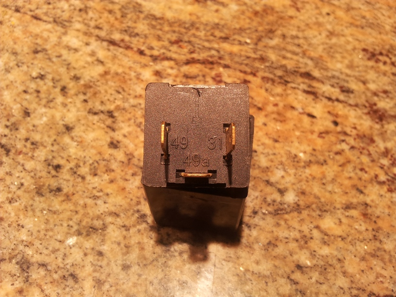

I though I would pick up a couple of these at $4 each as spares. One slight problem, they are missing a post. All 914 flashers early and late have 4 posts. Aren't reproductions supposed to be correct? headbang.gif It would cost almost as much to return them as they are worth.

If you ain't returning it, plug it in to see what it does. Is the cover a ground or "the 4th" post?
Spoke
It is possible that the missing post is the K/C2 terminal which drives the dash indicators. You can work around the missing terminal.

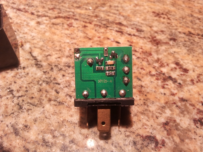

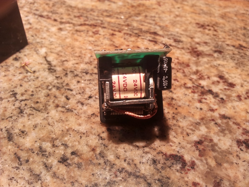

I took it apart to see. BTW the coil is 24VDC:

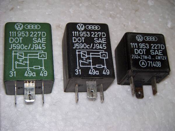

I also found this schematic online:

A real flasher relay has 2 coils and 2 sets of contacts inside. One set flashes the exterior lights and the other flashes the dash indicator. That is why they have 4 terminals.
Is it just a DPDT?

No. double coils, double single pole.
