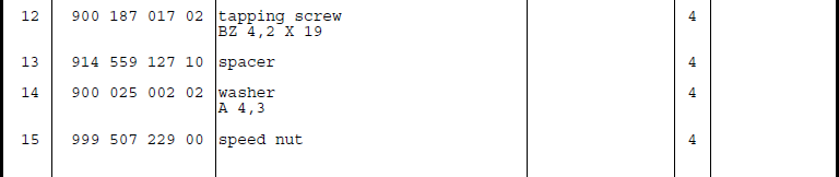

I found two speed nuts on the top side of my rocker panels, one on each end. The other four holes on the top had nothing. I presume that they fell off. I checked bell metric but they don't have anything this small

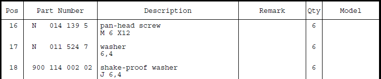

Mark yes it looks like the top screw is M4.2 and the bottom screw is M6 but I don't believe the M6 is a machine screw

#16 is a slotted cheese head metric, not hex Mark/Mikey914, & not Phillis Mark.
Phillips will cam-out before you get enough TQ on them to keep them in place.

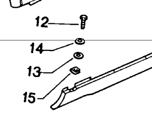

Germans apparently transliterated that to "pan head" - which I associate with a low rounded shape like the inside of a frying pan - but the originals on mine were cheese head, which are flat around the edge circumference & about 1/16 - 3/32" tall (as shown in the diagram if you zoom in) - & those give a bit more "meat" than a pan head for the screwdriver to bite into while torquing down or loosening them.
Also, #13 is a black nylon/sim. spacer-washer about +/- 3/32" thick, which are harder to find than white ones (I just looked for similar ones in white for my Westy table locking bolts, but saw no black).

The 4.2 screws (according to PET) are the same as #8. I was unable to find any speed nuts aka "U" nuts for the # 8 screws.
Are the M6 screws machine or space thread screws? Do they thread in to weld nuts?

The three on the bottom are the cheese head screws also used for type four engine tins.
https://914rubber.com/cheese-head-screw-set-1
Any M6x15 should work, though.

This is the original hardware. Three sets per side.
"cheesehead" screw with thread cleaner tip.
serrated lock washer and small diameter flat washer.
