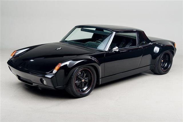

Just looking for pics for now. Unless there is a discussion already started on it. Im just a fan of clean lines and finding straight trim is always fun. I know I could just strip and paint the trim but I'm actually looking for completely removed trim and smoothed out.
sb914
boxsterfan
Black looks really mean and clean without the chrome. Not sure an all Blue or Yellow would have the same effect.

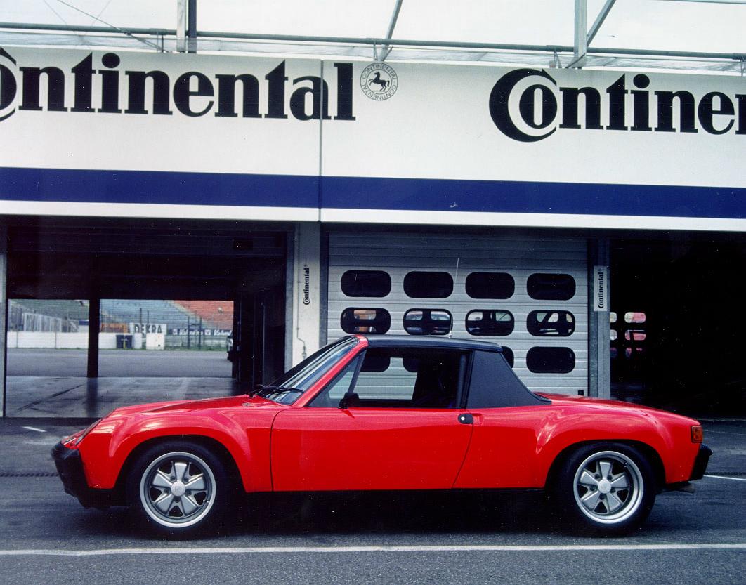

GermermanCarGuy
Found this in my photo file (not mine).Click to view attachment

QUOTE(GermermanCarGuy @ Sep 8 2015, 09:48 AM) *
This was a fashion trend in the late 70's & early 80's. Over the years, I watched the factory dechroming of VW's & Chevy's during this time period, involving mirrors, door handles, bumpers, window trim, etc... Probably other manufacturers as well but I remember those 2 the most. I liked it & always thought chrome was way too 1950's for my taste. Had the 914 continued production, I think it would have been dechromed as the one above is.

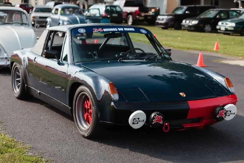

effutuo101
A couple in blue...
One Phoenix red (grey trim)
And one in green
There are a lot more out there

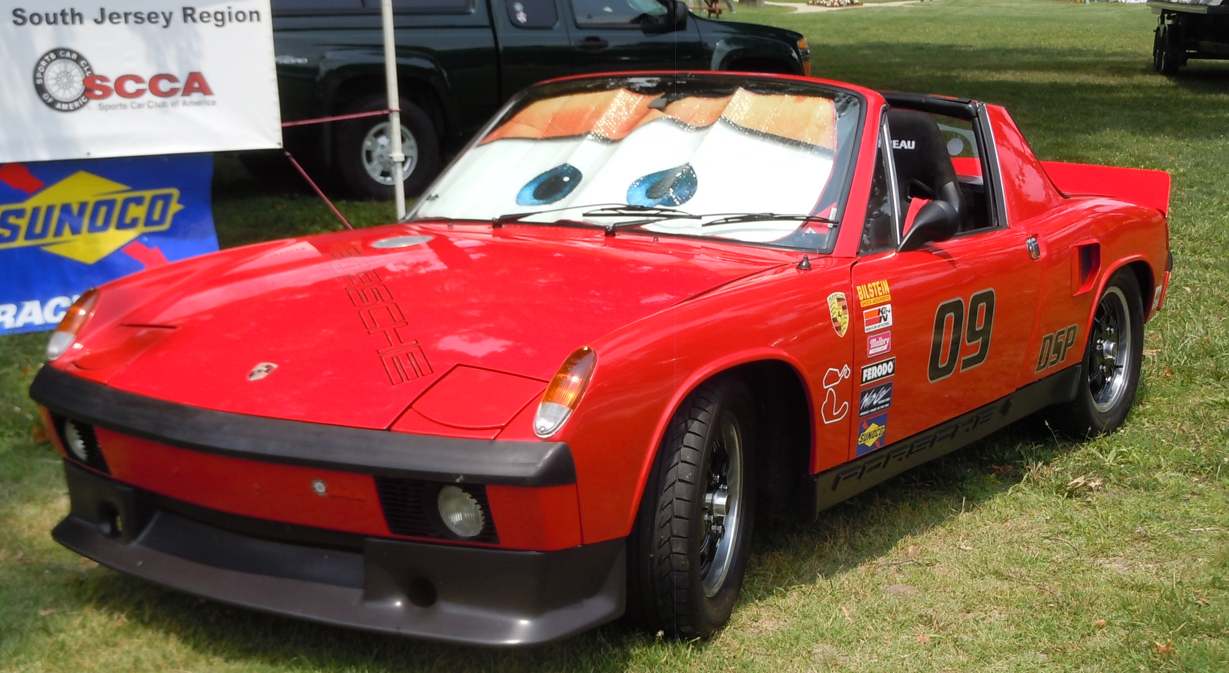

Geezer914
Guards red.Click to view attachment
