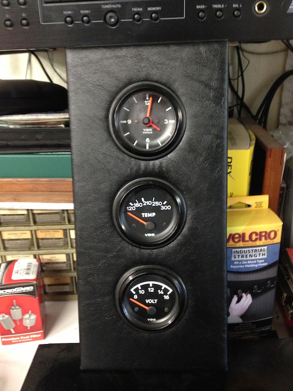

I sent my OEM temp gauge to North Hollywood Speedometer and they added temp numbers and a new sending unit. Works great and looks original.Click to view attachment
Ansbacher
Thanks a million everyone for the great info and pics. It looks like I already possess a newer type 300 degree VDO sensor, found one in my stash. Now I just have to order the 300 degree VDO cockpit gauge.
