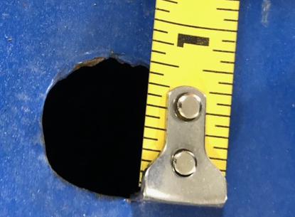

DennisV
QUOTE(buck toenges @ Oct 23 2015, 04:37 AM) *
Anybody know the size of hole needed for antenna opening in drivers side front fender?
I realize this thread is super old, but I don't see it was answered and I happen to have a photo handy. Perhaps it will help someone else down the road (bad joke intended). I'd call that 19mm?
This is a 1970 914-6 that reportedly had:
M453 Blaupunkt Frankfurt US retractable antenna with loudspeaker & noise suppression
