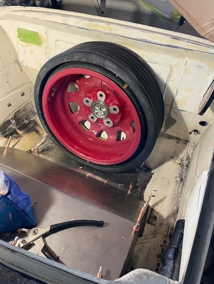

I'm still messing around with the front oil cooler install. I do not like the way the Setrab oil cooler fits into the GT shroud. I would need to bend the mounting tabs and slightly modify the upper and lower GT shrouds. I didn't want to spend around 3 grand on a replica GT cooler. It's a nice cooler but I could spend that extra cash elsewhere. I was checking out another's members GT build and saw he is using a PMB front oil cooler so I did a little research on that part. Looks like PMB modified a cooler to fit within the GT shroud without any mods to the shroud itself. I ordered one and waiting for it to show up. If I like the fitment of the PMB cooler better then the Setrab then I'll go that route.
Meantime I finished up the openings to the front trunk for the GT oil lines, front trunk fuel pump (late pump mod), and relocated the spare tire mount. I then spent a few hours prepping some replacement metal to fix the area under the fuel tank. See how next week goes and may get this section cut out and set up for welding.

Can I please ask, what size tire and wheel fit in front trunk?

QUOTE(Luke M @ Dec 13 2025, 09:08 AM)
Luke M
Dec 14 2025, 11:27 AM
Hi Matt,
I used a 6x15 cookie cutter with a 195/50/15 tire for mock up purposes. I'm running Boxster front and rear brakes so I would need a wheel/tire combo that would clear my brake setup. I believe that a factory Boxster spare would work but I haven't tried it yet. I'll have to borrow my brothers Boxster spare and test the fitment. If it doesn't work I may go with a 911 collapsible spare or buy a smaller tire and mount it on the cookie cutter wheel.

targa72e
Dec 15 2025, 11:01 PM
I am using Boxster brakes on my build as well. I am using a later model 16" spare with inflatable tire that will clear the brakes. These came on 996 turbos so will clear even larger brakes. I ended up making my own oil cooler shroud to use a cooler I already had.
