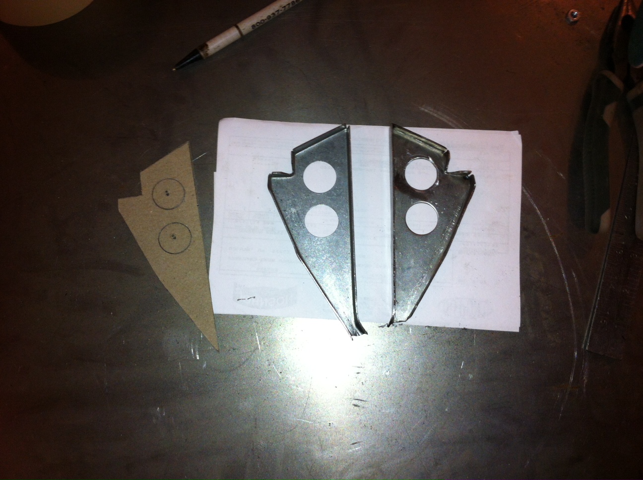

rick 918-S
Cool, you have a NOS sil with the correct triangle supports pre-welded. I was going to offer you a set of left side triangle supports I made. The RD ones are right side only. I made a jig to make a set of left side supports for Ben's 6 when I did his repair several years ago. You car is coming along nicely.
rick 918-S
Hey Luke, in response to your PM. Here are are the RD right and the left side one I made.
