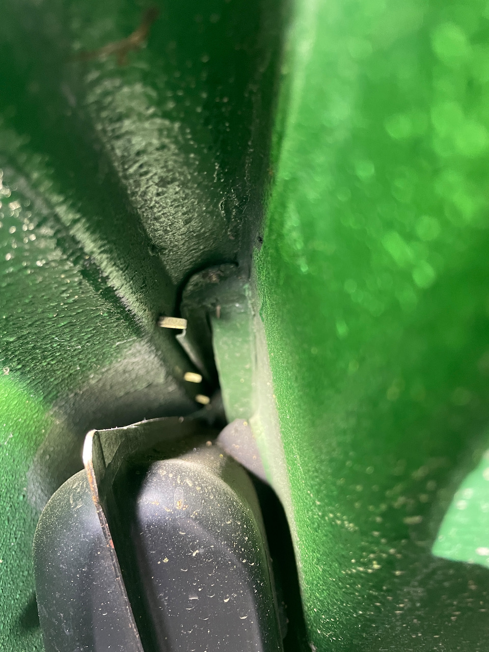

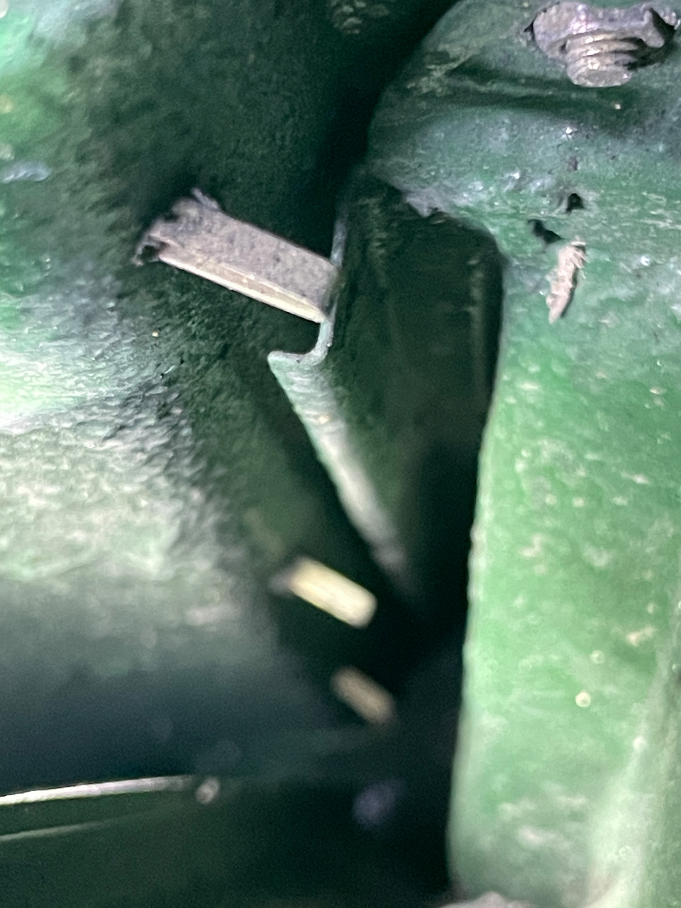

@Luke M - Sorry it took me a minute to get some pictures of my sail panel; we did not replace the foam. Blasted, epoxy primed, undercoated, painted. Man, my car is a little dirty from driving.
Your work is amazing; I am reliving my restoration while looking at your pictures.
Click to view attachmentClick to view attachment

Click to view attachmentClick to view attachmentHi Michael,
Thank you, I appreciate you getting back to me on this. Looks like there's no seal at all along that seam. I don't plan on driving my 6 in any bad weather or go off road so I should be good without a seal too.

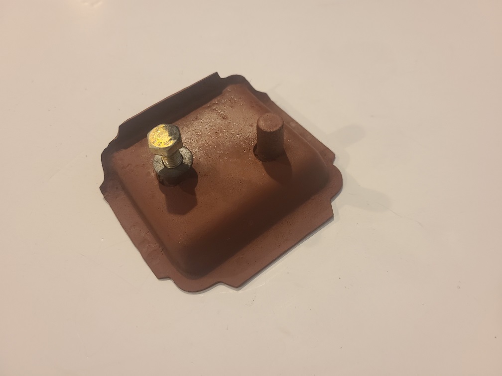

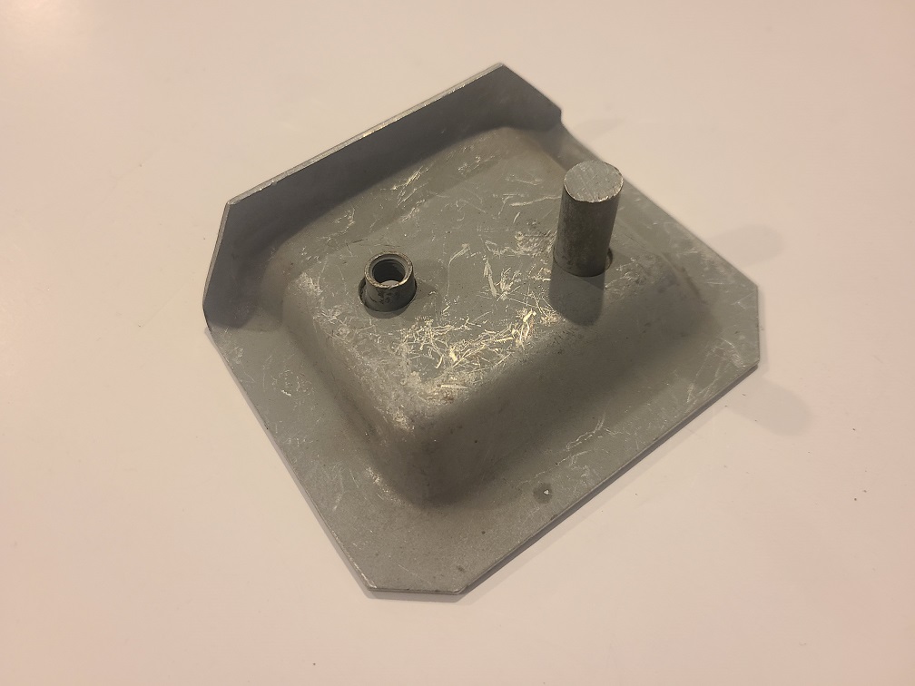

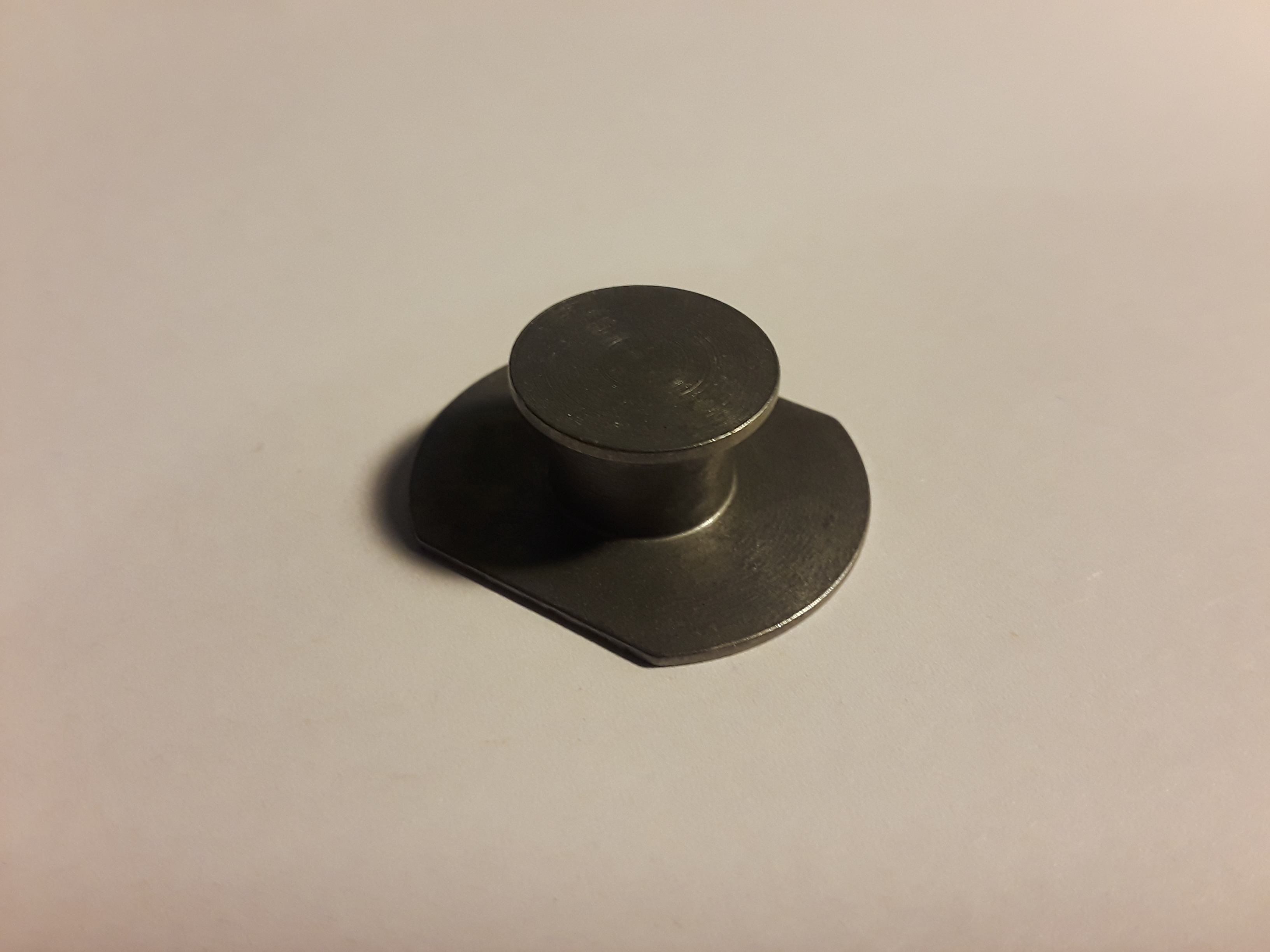

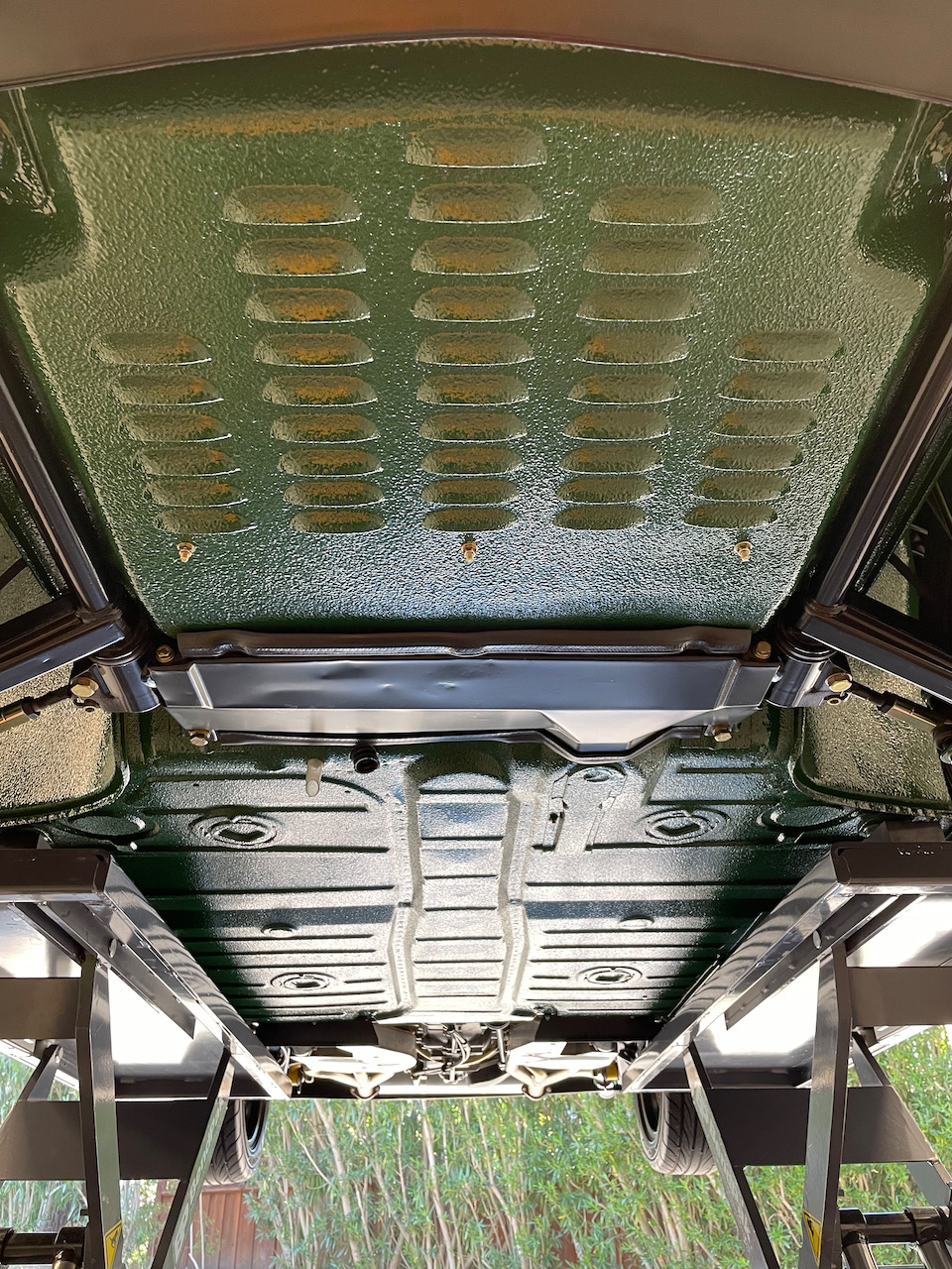

I've been chipping away at small tasks here. For those who run a front oil cooler and removed the tow ring for venting what was your fix to this? I came up with a bolt on tow ring almost like what Arno did on his GT project. I figured I'd ask before I commit to welding this in.
Cairo94507
Apr 29 2026, 07:30 AM
@Luke - Hi Luke - We just removed the tow hook all together when we did the louvered trunk floor panel. I added Tangerine Racing's tow "loops" to the front control arms which I feel is a much better solution.

roundtwo
May 12 2026, 01:41 PM
QUOTE(Cairo94507 @ Apr 29 2026, 06:30 AM)
In reality, my car would not be towed like that. But, if we need to trailer it, they make a great tie down along with his rear tie downs.
Cheers,
Michael
@Cairo94507
Click to view attachment Hey Cairo,
You have enough airflow with the louvered frunk pan?
I'm wondering about the adequacy now that I have mine in and working...I don't have oil radiator fans as the radiator is only about 4" tall...hard to size fans for my set up.
Thanks, Todd
