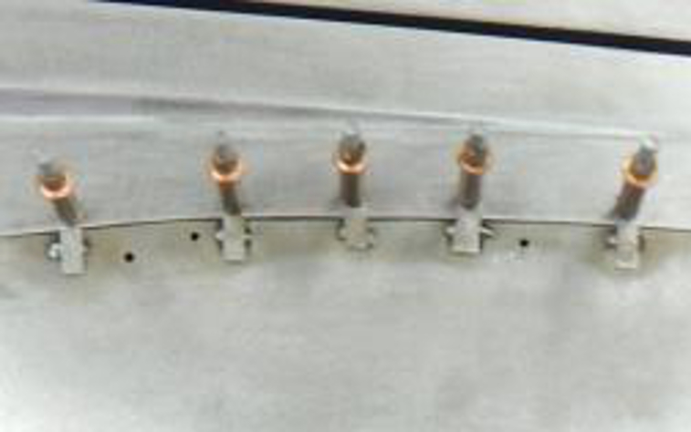

Click to view attachmentWell,I can honestly say I'm thrilled you discovered a cherry 9.14 in ..California.
A perfect vessel for the 3.2 and the requisite tubs,the 928 brakes to go with those enhancements.
I suppose,from perusing the bike pix,that you will do the flares personally.
I did a closeup to show the flanging technique with the tig torch,stitch-welding the sheetmetal to circumvent a warp factor.
(A phrase all too familiar from the '60s StarTrek,originally used by Rodders chopping T's n A's).
With a O2C2H2 torch we used the same 'Trick' to make butt and lap joints with bronze fillrod.Small bronze Robertson screws did the job too.
Show-goers would approach a custom Rod and say "Cool,the purple 'T' is Tricked out,Warp Factor 5".
Some grinding and hammering was involved,usually to begin again when things got ugly.
Enjoy the process,it should be a lot of Fun.
