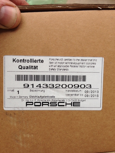

New axles came in. Looks like they are indeed made in Germany, not China.
That is awesome!

Can you show a side by side picture of a new joint next to an old one?
I wonder if they happen to be stronger/larger than old stock joints

maddin
QUOTE(Amphicar770 @ Jan 10 2016, 06:29 AM) *
past the use-by date! ;-)
