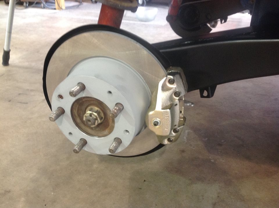

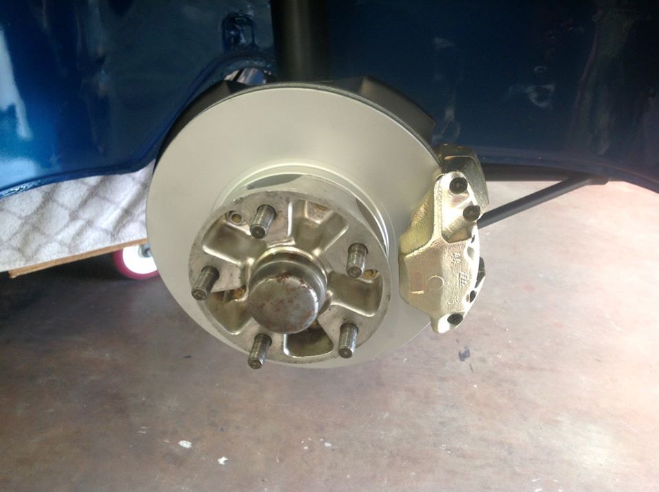

- I could be wrong, but the calipers almost look spray painted gold, and not re-plated. Just a weird color and notice how the bolts are plated and looks like there is overspray on the brake pads.

- and black painted (or something) hard brake lines. should be grey/silver.

HAHAHA!!!! Are you kidding me?!?! What were they thinking?!?! Spray painted calipers is one thing, but KYB shocks?!?!!?!

Spray paint on caliper. Spend $1,500 and really do it right and make the calipers perfect - but this type of work takes would could be an $80k car to $50k - paranoia grows and now lots of things to correct.

I can't help myself and keep looking. Looks like someone got "caliper plating" on the a-arm too! Doh.

Calipers...... eeeew
