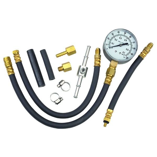

It was not easy to find something that screwed into the factory rail between cylinders, so I went to Harbor Freight and bought a fuel pressure tester.... Harbor Freight Link on sale for $20.
In the engine bay, I cut my new fuel line just past the hard line coming from the pump. I spliced in the silver union in the center of the picture. Did not use the hose clamps in the picture, used the German type. Then screwed the gauge into the new rail. Registers about 40. Alittle jumpy at idle, but very still at 3k rev.

QUOTE(malcolm2 @ Feb 4 2016, 12:44 PM) *
I have that same fuel pressure gauge tool kit. The difference with the JEGS gauge is that it is fluid-filled, which keeps the needle from bouncing around.
