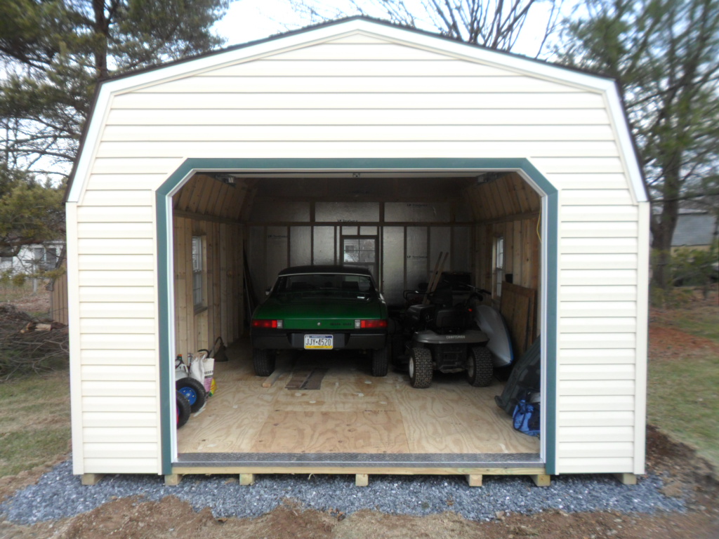

To give some perspective, I just bought a 14 X 20 garage. Even with the "smallish" size of our 914's, I think it would be tight to work in a 16' W space in a side by side configuration.
I'd offset the lift to one side so you have plenty of open space on the other side, or as Mark suggested, get a movable lift.
Keep us posted on what you come up with. Also, don't rule out applying for a variance with your local zoning board. I did it. It's a hassle, but may get you a few extra feet.
