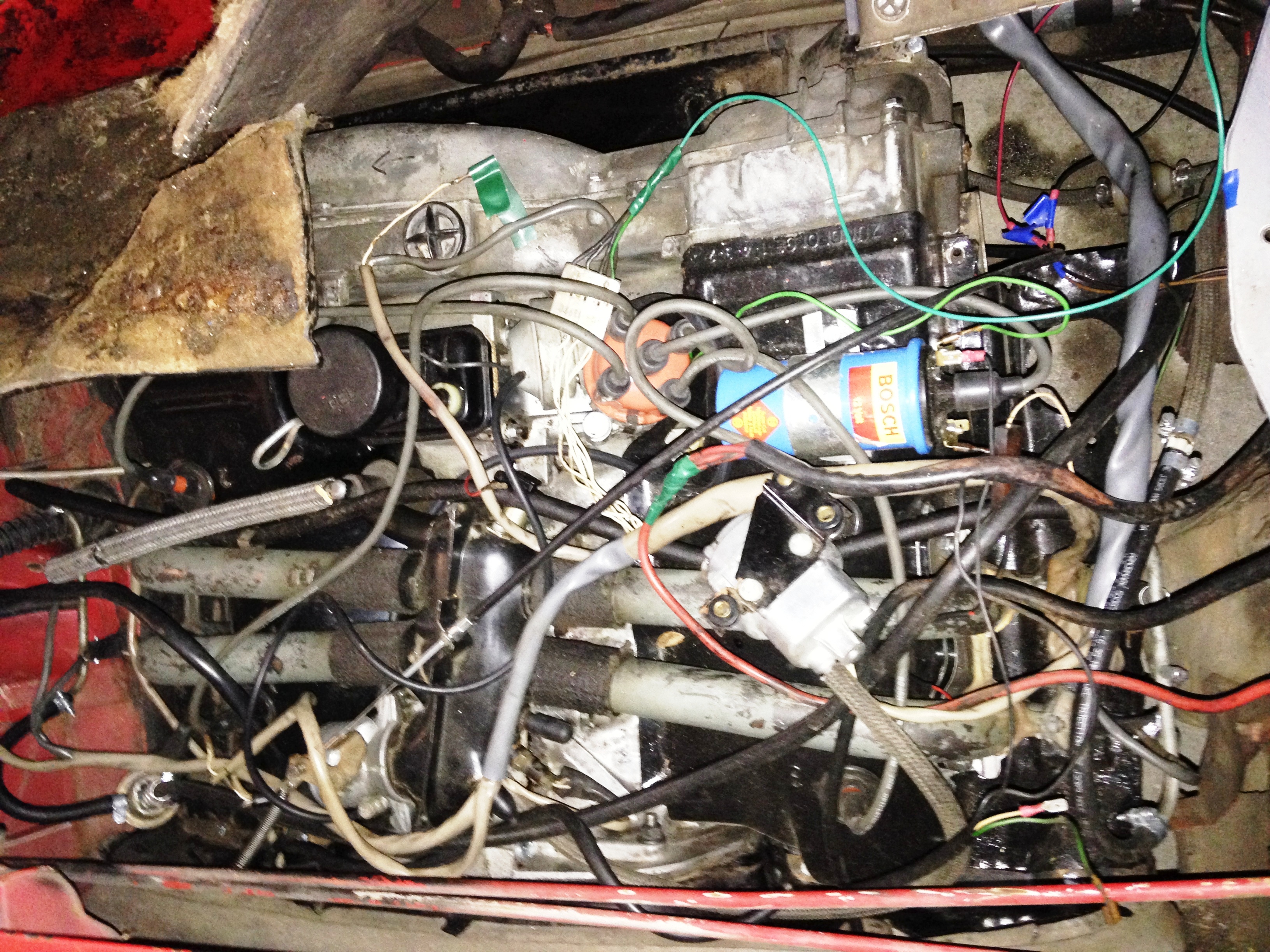

Post some pictures of the engine/engine bay so we can see what parts are being used.
And...
Gunn1
Feb 14 2016, 02:22 PM
Picture as requested.
I know its sort of a mess....No one ever said it would be easy!

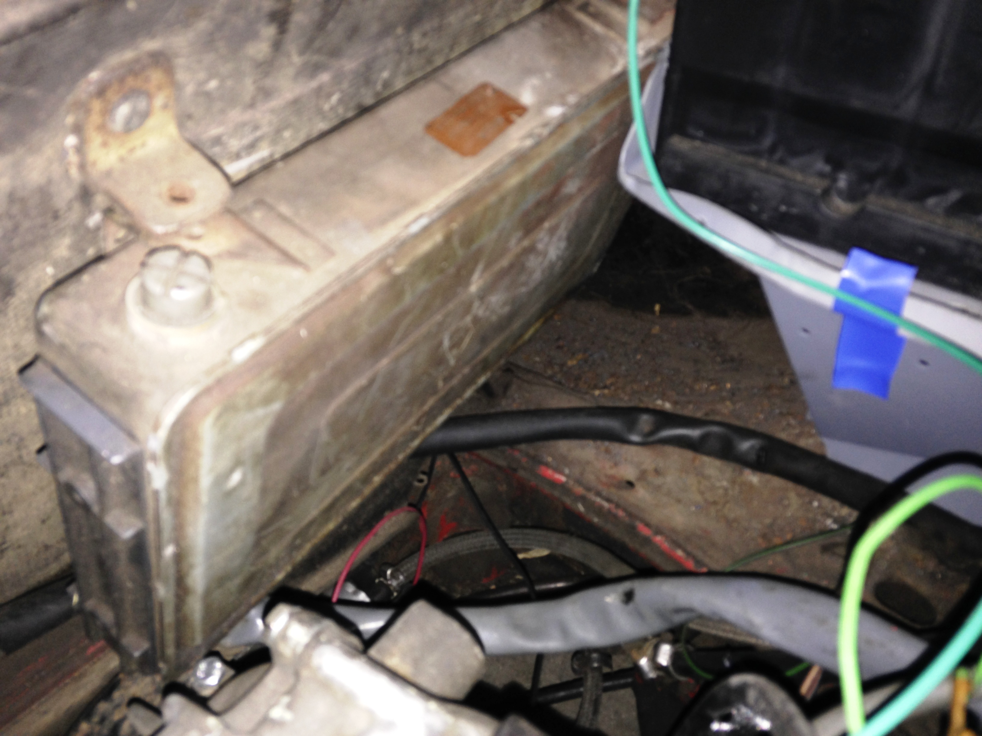

Gunn1
Feb 14 2016, 02:35 PM
Click to view attachment Picture of ECU.
r-towle, I will read the article and get the numbers of the ECU, MPS, TPS and CHT. Thanks

QUOTE(gunn1 @ Feb 14 2016, 12:22 PM)
Click to view attachmentWelcome to 914world!
Your engine is not really that messed except that firewall pad. You can just delete/remove that pad so you be able to see if there is some rush on the lower firewall area that needs repair.

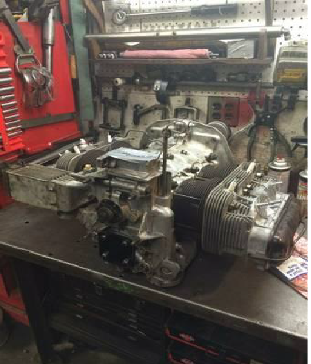

Gunn1
Feb 14 2016, 06:06 PM
Click to view attachment this photo was taken by the previous owner.
Its the only one I have of the engine after the rebuild, before it was reinstalled in the car.
