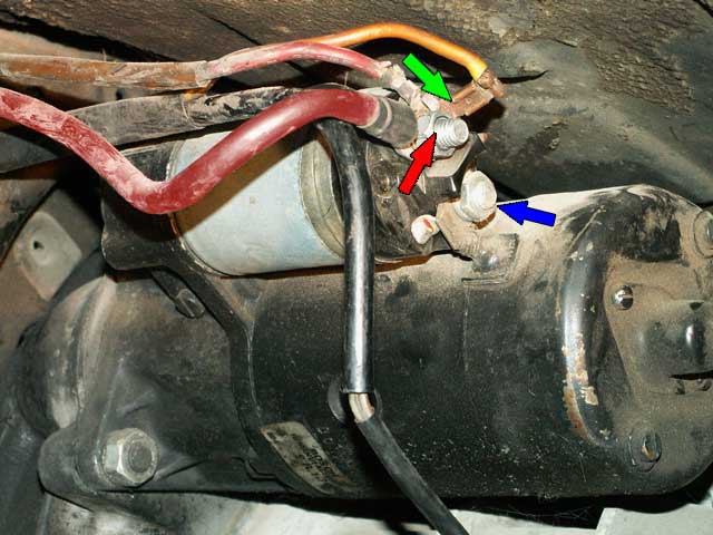

Rand
Feb 18 2016, 02:07 PM
Am I doing this in the engine bay or on the fuses under the dash?
Under the car at the starter. See photo. Rest a screwdriver on the main power terminal (red arrow) then slide it forward to touch the terminal at the green arrow. You don't need to worry about the ignition switch position because the main terminal is always hot and you aren't trying to start the car, just see if it tries to crank. You'll know in an instant! Of course be sure car is in neutral.
If it won't crank by the ignition switch, but does here, I'd bet a beer the ignition switch is cracked. At any rate, this will instantly narrow things down to the starter vs circuit.
