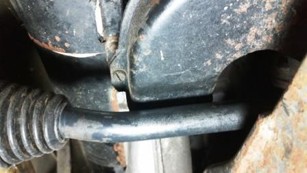

Here is my rub underneath. Previous to the bushing replacement there were none at the front or rear, only the middle position so I'm sure it wasn't rubbing. So is this a job for BFH or pry bar?

Finesse first. I have a lot of 1.7 exhaust and shifter parts from my car so figure out what you may need and they're yours for shipping. Everything should fit together without a hammer. biggrin.gif
Maybe throw up some more pics. The guys here are really good at diagnosing issues.

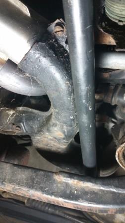

Could you post a bigger picture of where it rubs, meaning show more of the surrounding area

Looks like the left heater supply pipe is not fully fitted to the heat exchanger. Should be able to losen clamp and refit, which will move the air pipe to the left and give you some clearance.

Ok so got the wife out to run the gears and it's rubbing as I thought. The front to back or rotating on the tail shaft input part is pretty pronounced but the side to side at the tailshaft doesn't seem like a lot of movement. Maybe that's the way it works.
Keep in mind I've never driven this car so I couldn't tell you if I'm really in a gear and what gear at this point. Hopefully in a couple of weeks I'll have it to where I can go spin around the neighborhood. But it certainly doesn't feel like my past mustangs. smile.gif

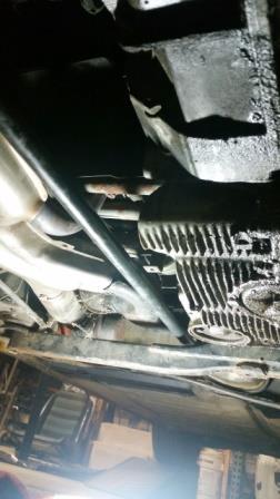

So here is a further back photo:

Ok so as above this appears to be the heater supply system not the exhaust. I scooted a bit further under and I see some screws on this piece. I'm guessing these will loosen and I can possibly shift this over to not be rubbing.

Yeah, a minor refit of that heater air pipe should give you clearance.

yup, it does look like the heater box is not mounted all the way onto the heat exchanger....that may do the trick.
