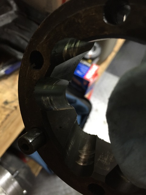

Hey Guys,
Just curious...how trashed are these CVs?
Ranging on a scale from..."you've easily got another 100K in them"....to...."it's amazing you weren't stranded".
Also curious how/why there are three distinct grooves.
Thoughts?

Looks like an even wear pattern on all the races. Not an expert in this area but I would use them.
914_teener
My thoughts are not scaler.
I.ve always understood if the races are grooved or chipped on the edges....replace em.
They are a 10 on the dirty frekin nasty scale....so you don.t want to do them again because you could get 1,000 more miles from them.
Those looked grooved to me, I.d replace them.
I've always heard if you can run your fingernail over the mating surface and feel a gouge, you should replace them. Replacing these can be an expensive proposition, so I'd love to hear different.

Those groves you likely can feel just running your finger over them.
If you can then they're done.

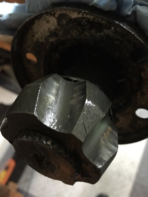

yep. can definitely feel the grooves, heres the other part...
