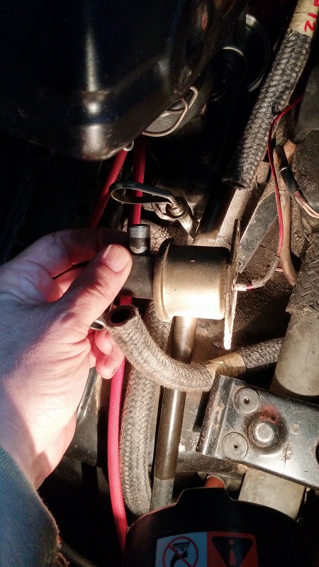

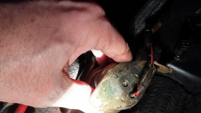

I found that my AAR appears to stuck closed, very poor cold idle, and then idles fine after warm up. I plan to PB blaster the crap out of the AAR and bench test it to make sure it can open and close correctly.
This may be a stupid question, but how is this lead disconnected, is it simply pulled off, or ??
Click to view attachmentClick to view attachmentthanks,
Turk
913B
Mar 10 2016, 05:20 PM
You don't want to take the wire off it is soldered to the other leg of the internal heating wire. Just leave it alone and be sure to place that heat shrink or additional tubing to prevent that wire from bending too much and shorting out. From my experience soaking it with PB didn't help for me. If you are capable of uncrimping the top portion and then soak it and manually turn it until it's free. It's not that hard, it won't look too pretty afterwards but it will work very smoothly. Good luck
JeffBowlsby
Mar 10 2016, 05:36 PM
Just disconnect the other end of that red wire where it connects to the ignition harness.
era vulgaris
Mar 10 2016, 05:37 PM
Been a while now since I had my djet car, but IIRC there is a plastic connector somewhere in the vicinity of the underside of the plenum. But maybe I'm thinking of something else. I can't recall right now how I removed mine, it's been a couple years. It's possible I cut it and re-soldered it together. Trace the wire to where it meets the loom and see if you find a connector somewhere along the way.
BTW, I soaked mine in a bath of WD40 for a couple days. After that it worked perfectly.
pilothyer
Mar 10 2016, 05:38 PM
I have found that in addition to the PB Blaster soak, you need to let it cool down and open, insert a small screw driver while it is open, then heat it up and it will try to close..........use the screwdriver to open it to maximum and then remove the screwdriver in such a way as to make the valve "Slam Shut" after a few cycles the carbon will be broken up and the valve will fully close as it should as it heats up.

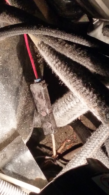

turk22
Mar 10 2016, 05:47 PM
ok, I see the connection on the other end. I'm guessing this is covering a spade connection? I don't see an obvious way to open this up, but the little bit of blue I see, looks like a simple crimp connection
Dave_Darling
Mar 10 2016, 06:18 PM
Correct, it's just a spade connection.

rgalla9146
Mar 10 2016, 07:33 PM
That blue collar is a crimp-on replacement connector.
It might not survive removal.
Solder a replacement on there.
