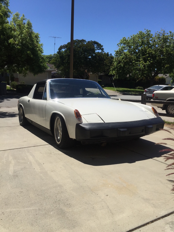

Like the title of this thread states, what would cause my speedometer to read a higher speed than I am traveling?
Is this a mechanical issue with the factory gauge?

Yes my new to me car is slammed and running low profile tires. Works well for the rotary motor.
^^ First project is to remove the BUBs ^^

They are 15" rims. I believe 195/50/15...maybe 195/55/15. Because the previous owner lowered the car as low as it would go, he had to run a small tire.
