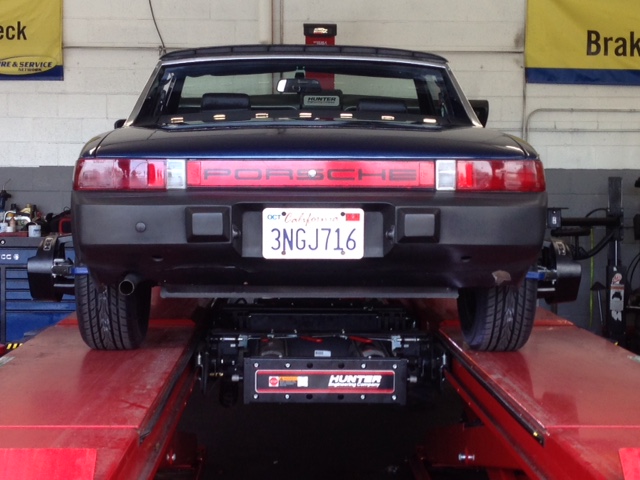

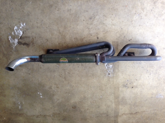

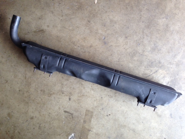

looking for a little guidence before i take off my old exhaust. Bought this bursch one used and just want to ask a couple of questions before i get into wrenching. as per the photos it looks to me the bolts are part of the old exhaust and if that is so then presumably I need the bolts and nuts to put on the bursch??? Is there a recommended set of hardware that i need to purchase?

Here are pics of the 2 types of Bursch mufflers. I have the one that looks like a regular muffler. Yours looks like the one that resembles the old "glass pack" muffler that guys used to put on their muscle cars. It's a straight through muffler with less back pressure and louder than the regular muffler.
I had one of those on my 1.7L and swapped it for a stock muffler because it was too loud.
