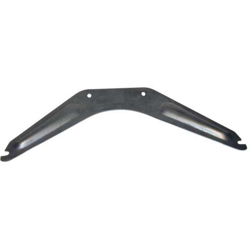

Another dumb question. When attaching bracket to tranny, which side faces forward?
Thx.
SA-914
Looking at mine the hump is towards the back.
r_towle
No need to install till you do the exhaust, and keep it loose until everything is lined up.
The arms are bent towards the rear.
