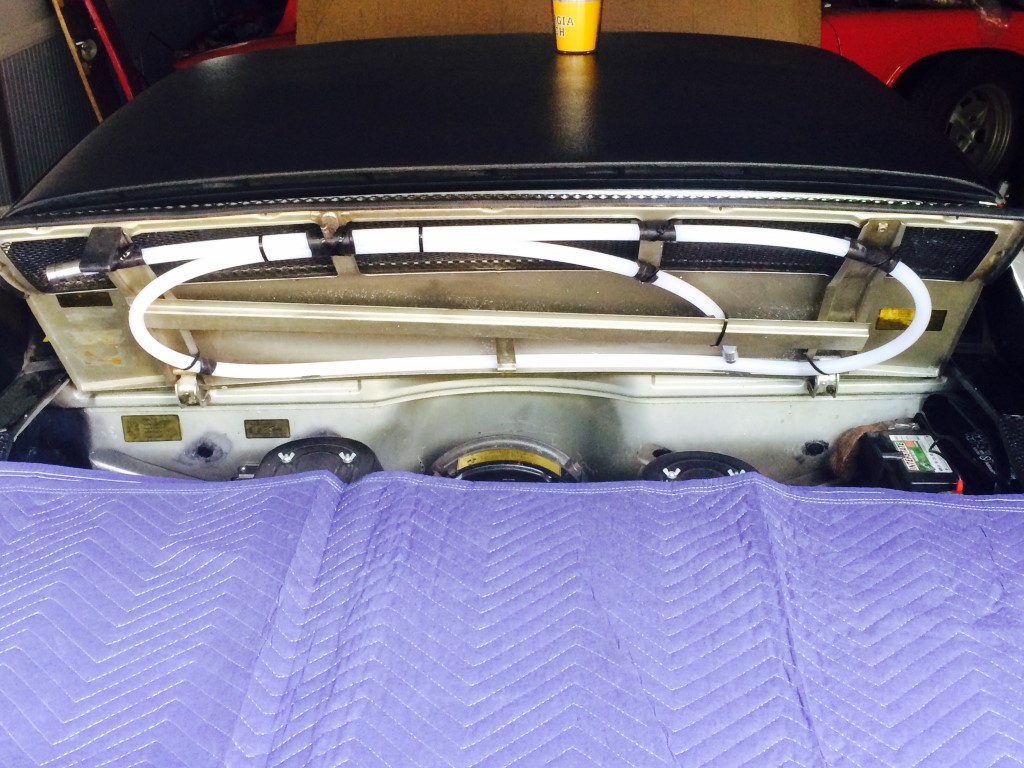

Running carbs on my -6 has caused me more times than I can count to think about the likelihood of a fire one day. I saw this on a member's car here I believe and so I investigated it and it sure seems like a good idea to me.
Its called BlazeCut and its a 7/8" plastic tube of fire retardant liquid that when subjected to fire, bursts releasing the liquid which immediately becomes a gas and extinguished the fire, leaving no trace to harm paint, electricals, etc.
Where the tubing comes in contact with the supports on the underside of the lid, I wrapped some of the self-fusing rubber tape to provide some abrasion protection and then used a number of zip-ties to anchor it securely to the lid. The springs don't have the umph to lift the lid as before but that's really no big deal as a trade-off for the protection.
There is a video of a demonstration on a VW bus on-line. I installed the 3 meter version on my -6 and feel a lot better about it.

I actually ordered a 3 meter unit and looped it around some. It fits just fine.
