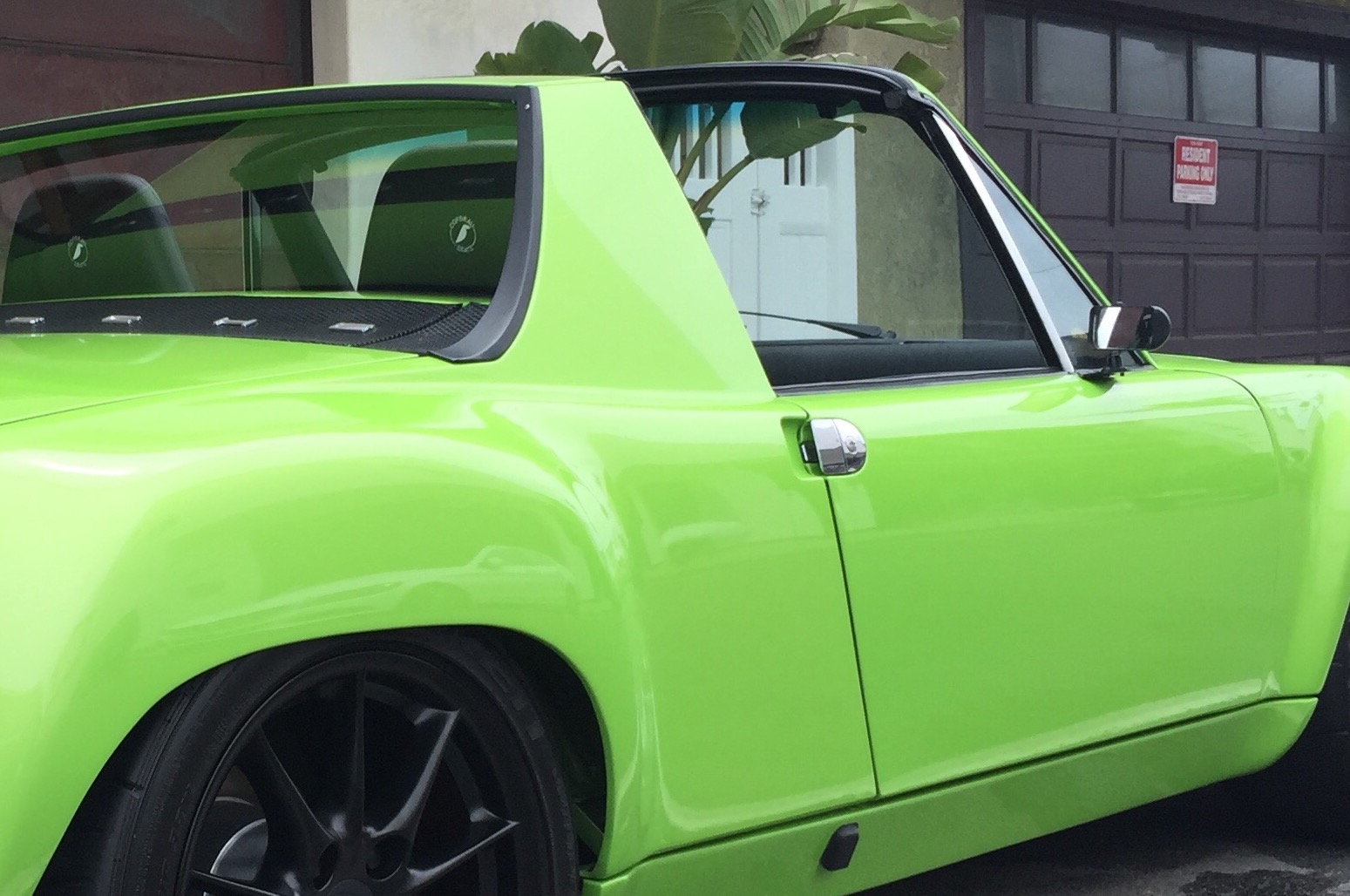

Here's a naked sail panel

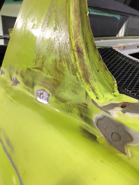

It's coming off on my green car, and here's an idea of what you find underneath. As for the holes, I'm welding them closed.
frankiec@outrageous.net
The holes drilled through the body to hold the vinyl trim will eventually have water running down inside the rear fenders of the body. I think it's a very poor design. Especially if you drive in the rain.
